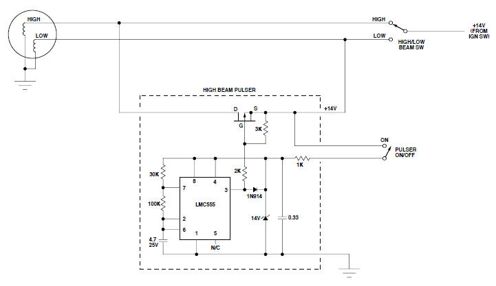

I’m looking for a schematic or tutorial for a dimmer capable of controlling a 12V 50W DC halogen spotlight. Commercial dimmers are expensive specialty items that won’t work for my application. There is no commercial dimmer that is saltwater proof. The dimmer will control a 2 mil CP spotlight and will be used for marine navigation. Lately I’ve been using a rheostat from an old truck heater; it generates way to much heat.

A simple 12 volt 5 amp PWM circuit encapsulated in hot glue or epoxy would work fine. However if I'm not mistaken halogen bulbs don't like being dimmed.

Dimming lowers the temperature causing carbon to build up on the filament. Running it full blast for one minute for each hour of dimming is supposed to alleviate that.

You could use a free running 555 timer with adjustable duty cycle driving a P-FET (high side drive) to the lamp to dim it. I would set the osc frequency to maybe 500 Hz ballpark. If the on resistance of the P-FET is low, the FET wll not need a heatsink. Here is an example circuit, you would want to make the 4.7uF cap smaller to get faster oscillation frequency. This one is designed to make a headlight flash as a warning light. The 30k/100k resistors can be varied to change duty cycle.
