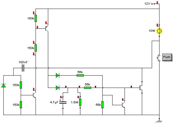

Hi All,
Built the following circuit for use in the car, adds a timed delay then fade of the courtesy light. The kit instructions say that it will flicker off then on again for about 100 milliseconds when the delay circuit kicks in.
I will post the circuit I made in Crocodile Clips, replicates the flicker that I assume I will experience.
Just wondering if there is a way to get rid of the flicker? Or if anyone knows an easier circuit.
Cheers all,
Tim.
