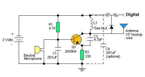

Suppose I select an LC tank circuit from a BJT transistor FM transmitter. see miniature transmitter #2 at **broken link removed** for an example.
Would the following modification (see attachment) allow me to change the frequency using outputs from any digital IC, and by altering the resistor in series with the output?
and what are the minimum and maximum capacitances I can obtain from the 1N4007?

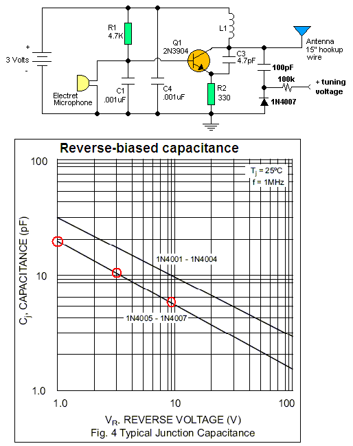

You might as well capacitor-couple the varicap like all other circuits so you can bias it with a positive voltage referenced to ground. It won't be connected to the tank with your coupling resistor.
I guess the tank's stray capacitance is 5pF, the transistor is 3pF, the antenna is 5pF and the feedback cap adds a couple for a total capacitance without the varicap of 15pF.
The capacitance of the 1N4007 is 5.5pF at 9V, 10pF at 3V and 19pF at 1V.
You can calculate its limited tuning range due to the high stray capacitance in parallel with it.
Can I use the series-capacitance equation to get the resulting capacitance from the diode and the 100pF and make that my C for my LC tank?
and why is the coupling capacitor so small?
Yes you can, and it would be a good experience, and you will then see why you don't need to.
It's not, it's large (with respect to the varicap) - that's the whole point, it's large enough to not have any effect on the tuning, it's basically transparent as far as the circuit is concerned.
