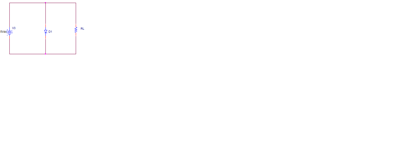

I was trying to analyze the diode circuit as regulator. I have drawn a circuit consisting of 5V- DC power source, the diode and the Load resistance. I replaced the diode with the ideal model, and since the diode is forward biased i replaced it with a constant voltage source of 0.7V. Now the problem is I always get a current of 0.7/RL irrespective of the 5V supply or the load resistance. Is it the correct way of analyzing what am i missing?
You must add a resistor between the positive pole of the battery and the anode of D1. The series resistor provides a voltage drop of Vbat-Vd. This is how the diode/resistor regulates; the excess voltage appears across the series resistor...
Note that you have built a thermometer.
You placed two ideal voltage sources in parallel. That is not allowed.
Also, 5 volts directly across a more realistic diode model will create an impractically large current through the diode.

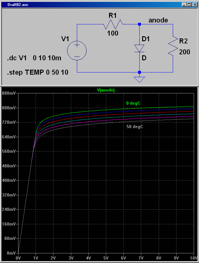

That is also not a good way to make a voltage regulator for stability reasons. The diode voltage depends too much on temperature.

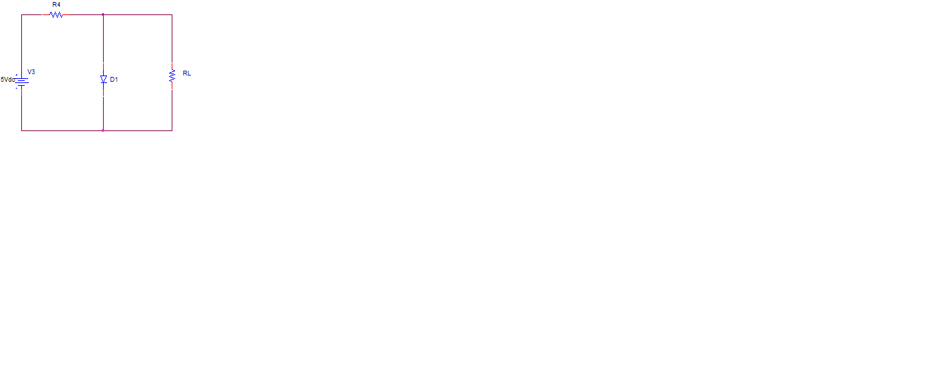

Suppose if i modify the circuit considering then the current through the Load resistor is still the same 0.7/RL and the output voltage is always 0.7V. Will this circuit ever fail or the diode will keep supplying the current to load? That is when the diode will fail and stop regulating. Please help.
The diode does not "supply current to the load". It shunts current around the load. It, in effect, wastes some current to achieve the regulation.
Potential failure modes are power dissipation in the series resistor (P=IE) exceeding the resistor rating, and the same for the diode. The series resistor (your R4) passes the sum of the load current and the diode current. The ratio of load current to diode current should be set about 1:1.

Suppose if i modify the circuit considering then the current through the Load resistor is still the same 0.7/RL and the output voltage is always 0.7V. Will this circuit ever fail or the diode will keep supplying the current to load? That is when the diode will fail and stop regulating. Please help.View attachment 93115
The diode will stop regulating when the voltage across it falls below 0.7 volts. That will happen when the battery voltage is to low or the load current is to high.
