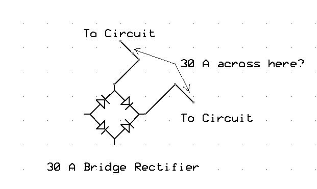

For a circuit I'm making I need a 30 A diode, however I cannot find a 30 A diode in any of my local shops.
If I got a 30 A Bridge rectifier and wired up just one diode, could this one diode withstand 30 A?
The circuit has a 20 A fuse in it, so the 30 A diode is very conservative.

If you considered the -V terminal as the 'ac' input, strap the two usual 'ac' inputs together as the output this would put two diodes in parallel.
One diode of the bridge should be fine at 30A, if the bridge is rated at 30A
Please post a schematic?
I know diodes don't share current very well but two 20A diodes should be able to carry 30A.

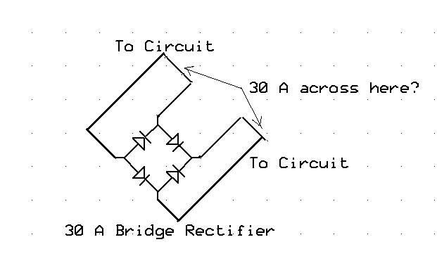

Here is what I want to do.
The diode bridge is rated for 30 A so will the single diode also be?
Tom

That should be fine but it might not be needed, you might be able to use a single, smaller diode but since you haven't posted a schematic of the circuit you want to use the diode in, we can't tell you.
EDIT:
It's also possible to parallel two of the diodes which will cut the voltage drop, reduce the power dissipation and increase the reliability.
You'll also be able to use a bridge with a lower current rating - 20A should do for 30A.

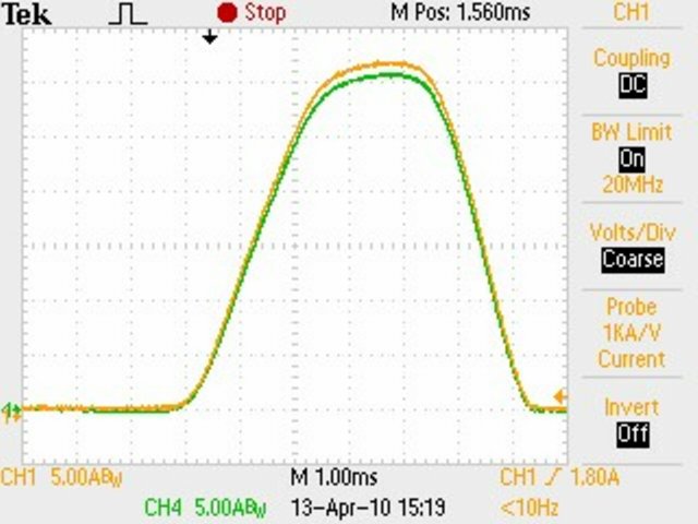

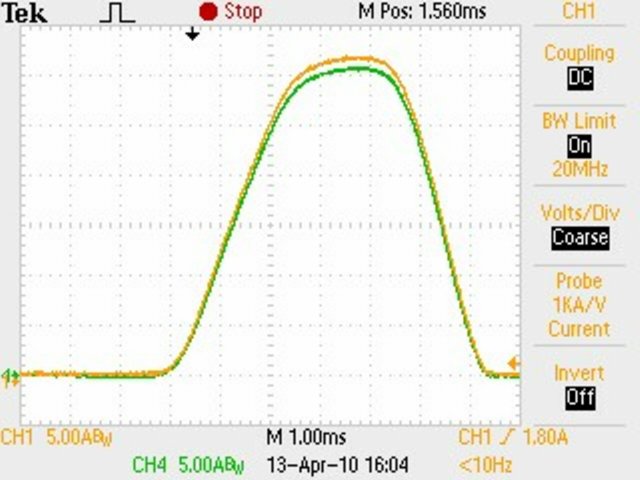

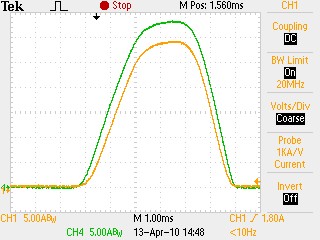

Here is the result of an experiment. I took 2 identical 20 amp diode bridge assemblies, the type where individual diodes are mounted in a package, electrically isolated from the package, but on the same thermal substrate, which is intended to be mounted on a heatsink. I did not mount the assemblies on a heatsink.
I used a large 2 kW transformer, with a 120 VAC primary and a 12 VAC secondary. I connected one diode from each assembly in series with a .001 ohm shunt to monitor current, connected the 2 diodes (plus shunt) in parallel, with heavy wires, and placed the combination across the secondary of the transformer. With a variac on the primary, I could gradually increase the current through the diodes which were simply shorted across the secondary. I avoided any excess resistance in series with the diodes, which might act as ballast, tending to equalize currents. I captured scope images of the diode currents, with different colors for the two currents..
I first increased the diode currents to about 30 amps peak, starting with cold (at room temperature) diodes, and capturing the current traces before the diodes had time to warm up significantly. The first image shows this situation.
I then waited several minutes until the diode packages were blazing hot, about 120 degrees C according to a thermocouple measurement. The second image shows this result.
Finally, I allowed the diode assemblies to cool back down to ambient. Then I used a hot air gun to heat ONE of the diode assemblies to about 100 degrees C, with no current in the diodes. Then I quickly applied about 30 amps peak to each diode and captured the scope trace. This result is shown in the third image.
It can be seen that there is good current sharing between two diodes in two different packages, even when the diodes are allowed to heat up without heat sinking, at fairly high currents.
Even with the extremely unfavorable case of pre-heating one diode to 100 degrees, the other remaining at room temp, the degree of mismatch in currents is not much, 29 amps vs. 33 amps peak.
As Hero999 said, if the diodes are all in one package, they will tend to be matched, and the thermal substrate they are mounted on will not allow any one diode to get much hotter than any other. And, the normal resistance of connecting wiring will tend to ballast the diodes; I was careful to avoid this effect as much as possible by using short, heavy, connecting wires.
The problem you describe is a non-problem for this type of bridge rectifier assembly. A user can safely use two diodes from the same bridge in parallel, with the effective current rating doubled. Proper heatsinking is required, but considering that a bridge rated for 20 amps is rated that way with all 4 diodes carrying current, if only two diodes are used I would think that perhaps even somewhat more than 20 amps will be within ratings.
