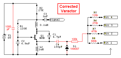

Here it is.
The circuit in white is my regen detector that I will consistently use, because IT WORKS.
The circuit in yellow is my add-on. I took audioguru's version of his varactor tuned transmitter and modified it slightly to suit my circuit, because my (LC tank) inductor is grounded. Like he said, I didn't use a limiting resistor between the voltage source and the junction between the capacitor and the diode.
The bit #'s are the bits on the counter output. Bit 1 is the first bit (LSB?), the one that turns on first when I activate the clock on the counter.
After pressing the button about 14 times (with a 4.7pF capacitor tied to the LC inductor which isn't shown), I got a signal.
If I didn't use a divider network with the 680K resistors, then I would have a problem when all bits are on or off.
Assume there were no 680K resistors:
If they are all on, all resistors will be internally (according to the 74HC393) tied to VCC, and there would be no resistor tied to ground.
If they are all off, all resistors will be internally (according to the 74HC393) tied to ground, and there would be no resistor tied to VCC.
The goal is to provide a voltage, and my way of doing that is to always use a 2-resistor voltage divider.
and the R-2R ladder is something I will pass up on, because I see no benefit with it.

Hi Stubborn,
1) The varactor diode is supposed to be reverse biased.
2) Without a 100k isolating resistor, the output of the resistors of the counter were a 680 ohm RF short across the tuned circuit.
3) Where's your supply bypass cap?
4) Use a diode that has enough capacitance to do the job.
5) There isn't a requirement to waste up to 9mA and lose accuracy in very low value resistors from the counter.
I won't comment on the rest of the circuit since you say it works.
Try it like this:

I found a mistake in my upload. both inductors should be 0.1uH.
and yes, I will up my resistance values at the counter.
and I have a comment for Audioguru:
Isn't your "corrected" varactor equivalent to LC in parallel?
Mine should be equivalent to a capacitor connected between emitter and VCC.
I am still deciding on the bypass capacitor. Experimentation so far is a good answer to me.
and why isn't my diode reverse-biased when the cathode of my diode is connected to VCC?

Get rid of your 680k resistors and add the 100k RF isolation resistor.
Of course. Then it tunes a station and rejects others.
You still don't understand the function of a supply bypass capacitor.
With the tuning capacitance connected to VCC, then the circuit would work only if the battery is brand new so has a low internal resistance and the wires to the battery are very short so they have low inductance.
With a supply bypass capacitor to make the RF potential of VCC and ground the same, then the tuning capacitance can be connected to ground or to VCC and even with a weak battery it will work the same.
Sorry, I thought the anode was at VCC. The diode should be connected to ground like in every other circuit.
With the diode connected to VCC and with the same supply voltage for the counter, the tuning is backwards. When the counter is reset then the resistors will have zero voltage output and the capacitance of the diode is at its minimum and the RF frequency is at its highest.
With the diode connected to ground like I show it, when the counter is reset then the radio will tune to its lowest frequency. Then clocking will increase the frequency. Isn't that what you want?
You are using an ordinary diode to replace a varactor which has a much wider tuning range. The tuning range with an ordinary diode isn't enough, unless you increase the supply voltage of the counter for the diode to have a wider tuning range. With the diode connected to ground like I show it, you can increase the supply voltage of the counter if you use a CD4024 counter with its much higher VCC rating. :lol:
Then I shall use a few uF's for the capacitor, just so that the AC-VCC and AC-GND are the same.
Diodes are cheaper. In fact, I am willing to switch to zener if it is necessary. I have used 1N5221's before (tiny red diodes) in my very first superregen, but they tend to break down easy (even on the smallest circuit mistake).
If I were to replace the diode with a diode with a higher tuning range, should I go for the 1N5221 or some other diode?
I don't want to blow my money on a varicap and find out later that it is useless.
Also, my supply voltage must be switchable between 6 and 9V, because I want my receiver to work on an almost dead battery. and so far, my receiver works from 9V to 6V. The only thing I might have to do is alter the jumper setting in my circuit.
so your idea of higher VCC isn't going to go well with me or my circuit.

NO, NO, NO! A few uF's cap is useless at these high RF frequencies due to its inductance. You need a 1000pF ceramic disk cap with very short wires.
Use an additional 100uF to 1000uF to bypass audio frequencies.
You didn't look at the datasheet for a 1N5221 3.3V/20mA zener diode.
Low voltage zener diodes are lousy for anything. With a reverse voltage of only 2.6V, it typically leaks 5mA. Its capacitance is far too high and its range isn't enough for your application.
You should use a proper varactor diode for tuning. If you can't afford mail-order then go to the dollar store and buy a "scanning FM radio" for $1.00. It is a lousy radio but it comes with stereo earphones (the radio is mono) and two cheap AAA battery cells. Its varactor diode tunes the entire FM band with less than 3V. I didn't look but its parts are probably tiny surface-mount.
