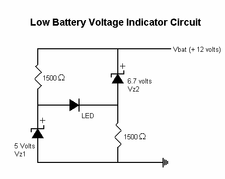

Alternatively, a couple of zeners at 6.8 V and two resistors will work but will take quite a lot of power when on. The circuit is here:-
(It's set for a lower voltage, so you will need larger value resistors and higher voltage zeners)

There are Zener diodes, but they start to conduct at a specific voltage rather than stopping, so need a bit of additional circuitry.
This is the simplest circuit I can find that will turn the LED on below a specific voltage:
That works by the zener diodes diverting the current through the resistors when the voltage increases above the point where the voltage between the two side junctions is less than the LED forward voltage.
The two zeners should be somewhere roughly around half the supply voltage, and total to about 1.8V more than the voltage you need the LED to light.
Two 7.5V rated ones may be suitable; that would give a threshold around 13.2V with a typical red LED.
A simple circuit like that will draw current all the time, LED on or off.
You can use eg. two lower voltage zeners in series to get other voltage steps; low voltage ones are available in smaller increments.

Here's a simple circuit to light an LED below the desired voltage.
It uses a programmable TL431 voltage reference as a comparator to get a precise and stable trip point.
This trip voltage can be adjusted as desired by changing divider resistor values R2 and/or R3.
The TL431 turns off when the Ref voltage from the divider goes below 2.5V, allowing current from R1 to light the LED.
The simulation shows the LED current going on and off (red trace) when the battery voltage (green trace) goes below and above a nominal 13.5V.
