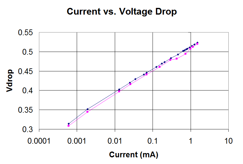

Man, I still don't get the physics of it, but it seems to work pretty well. I've attached a graph of two separate C-B connected ZTX869's where I varied a potentiometer and took current readings and voltage drop readings for several points and they both follow pretty close to the same logarithmic curve.
Thanks again,
Mike

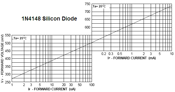

The graph of the transistor is about the same as the graph of an ordinary diode.
Audioguru:
It is roughly the same (it's definitely a log curve), but the transistor has a shallower slope (~.32 at 1uA and ~.52 at 1mA). I haven't (so far) been able to find any plain diodes with a slope that shallow.

After looking around a bit, I realized this is a "diode-connected" transistor and I have seen it before in current mirrors and the like. But I'm still not sure what sets that slope. The diode equation is Id=Is[exp(Vd/nVt)-1]. Vd and Vt (voltage across diode and thermal voltage) should be roughly equal between a diode and a diode-connected transistor. I guess that the saturation current (Is) would have the most effect on the slope. There probably are diodes out there that have matching or even shallower slopes, but I get tired of poking around after 30 or 40 spec sheets.
