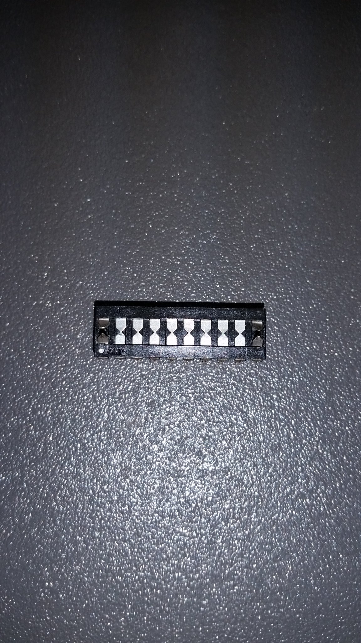

I am working on an older ESC 8816 data logger and found what appears to be a couple of fuses blown on a DIP 20 package. I have never seen anything like this and a google search comes up blank. Any Help would be appreciated. The only lettering on the piece is the word AMP and a numeral 3. I assume it is a 3 amp fuse.

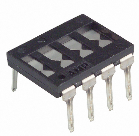

I think they are not a fuse.
They are a switch. I will look for a data sheet.
Thank You so much Ron. Would never have guessed that to be a switch. Definitely Bird Brand. AKA Cheep cheep cheep!!!
It is more of an option strap , boards could be set with an communication address or a ram size etc etc sort of thing that is set once at installation , much better than switches ....
