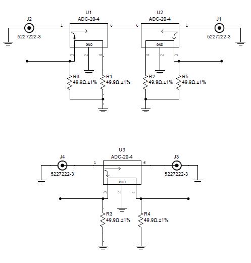

Hello, I have a few questions on couplers. I want to sample both forward and return signal. In one website I visited concerning couplers, they said you should use 2 couplers back to back, but this adds insertion loss, and I don't like that. Can't I just use one? Also, I assume all ports should be terminated into 50Ω, am I correct? So which way is correct in my attached image?

From this I think that your scheme with the single coupler module will not work as you hope for.
The first scheme with the two modules should be OK within its limitations.
When I first saw the datasheet for the MiniCircuit coupler module, my thoughts were that the directivity was not very good. This is (sort of) confirmed by end of the Microwaves 101 article in the section about reflectometers.

Guess I will go with 2 couplers. I will see if I can find a coupler with better directivity (Is directivity the isolation between the 2 coupled ports?). I think internal terminations will also be better.
This part on the website confuses as it pertains to terminations. The part in red, is that to say the coupled port should be un-terminated? Im confused.

The only directional couplers that I could find with better directivity of about 30 dB were about $380.0 I don't think SMT versions get much better than 20 dB
