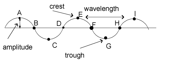

Hi akg,
i am trying to learn more and more
with the torch example i think your mean aboy beam width is "amplitude"
of sound wave, am i right?
another question:
if we make a VERY high freq like 1MHz then what will happen?
can this freq be vibrated by air molecules?

another question:
yes afiak . ultrasound can go beyond that freq. the air molecules shld vibrate , otherwise no sound wave.
but heavier objects (compared to air) like water , diamond wont vibrate.
so US creates 'cavitation' in water and holes in diamond (due to heating)
