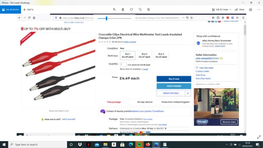

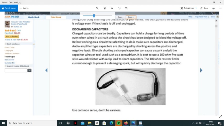

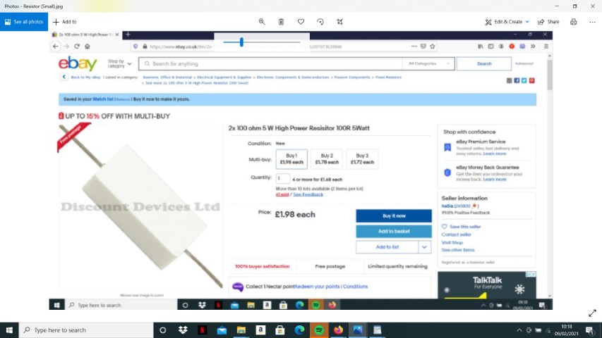

As in the attached screenshot, the same 100 ohm 5 watt resistors are available on Ebay. I was wondering about leads though, the ones I see on Ebay, their voltage rating is 30V ac and 60V dc. Would these leads be suitable for discharging tube capacitors?
Thanks.
Yes, is the quick answer.
The longer answer is that it may be cheaper to buy a packet of small croc clips and a reel of wire and make your own leads.

any well designed tube amp has bleeder resistors in the power supply, and as long as there's nothing wrong with them they usually discharge the caps to 10V or less in about a minute or so... a 100 ohm resistor for discharging a 350 to 500V supply is still going to spark, and i don't think a 100 ohm 5W resistor would last very long( 3.5A through the resistor, at a voltage of 350V gives in excess of a 1kW power spike)... a 100K 5 watt would work better, no sparking, and well within the thermal limits of the resistor.
The sparking noise while discharging a 400 volt, 100 uF capacitor is very uncomfortable.
However, it is far more uncomfortable discharging it through your finger.
Ask me how I know.:(

" Despite the presence of a bleeder, it is wise to prove that any potentially dangerous capacitors are discharged, perhaps by shorting their terminals (or through a suitable low resistance for high energy capacitors), before working on any circuit. "
Says suitable low resistance for high energy capacitors.
I've ordered, Vacuum Tube Amplifier Basics by EJ Jurich, the author has over 60 years of practical hands-on vacuum tube amplifier experience repairing and building custom audio gear including studio and recording equipment, professionally worked in radio broadcast engineering for 40 years.
In the screenshot from his book that I posted above. He says, " It is best to use a 100 ohm 5 watt wire wound resistor, with a clip lead to short capacitors. The 100 ohm resistor limits current enough, to prevent a damaging spark but will quickly discharge the capacitor. "
But unclejed613 says, " a 100K 5 watt would work better."
Please clarify?
Cheers.
Please clarify?
As stated earlier, a screwdriver across the capacitor terminals is a quick, easy and sometimes spectacular method of discharging a capacitor.
I remember one instance where I shorted a capacitor, accidentally I think, it was 50 years ago, the equipment was powered at the time but the capacitor was internally damaged, it appeared to go open circuit.
The equipment, a Marconi CR100 receiver instantly developed a very loud mains hum which was cured by replacing the capacitor.
If I wanted to be very precise about it, I would:
1 switch off.
2 unplug from the mains.
3 measure with a multimeter.
4 short the capacitor with a 1k Ohm resistor for 10 seconds.
5 measure with a multimeter.
6 get on and do the job.
Consider, the time constant of an RC circuit is given by
t= CR
t in seconds
C in Farads
R in Ohms
A typical HT supply in a valve amplifier may be 100uF
Our discharge resistor is 1k Ohm
time constant = 100 x 10^-6 x 1 x 10^3 = 100 x 10^3 = 100mS
So if we discharge our capacitor for 1 second, that is 10 time constants, so all the charge will be gone.
But beware, discharged capacitors can recharge themselves due to a property called dielectric absorption.
When the discharge path is removed, energy "comes back out of the dielectric" and the voltage across the capacitor terminals rises a bit.

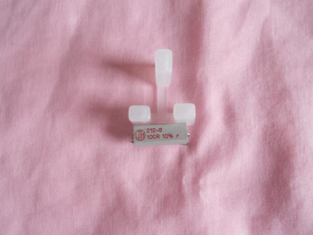

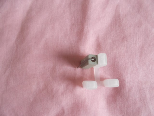

To discharge capacitors I ordered a 100 ohm 5 watt resistor, as shown in attached screenshot. But unclejed613 said, " 100K 5 watt would work better, no sparking, and well within the thermal limits of the resistor. " I contacted the seller to cancel my order, but already posted.
I received it yesterday, it looks different to the one in the screenshot. The markings on it say, 212-8 100R 10% r.
Have I been sent the correct 100 ohm 5 watt resistor ?
Cheers.

Thanks Nigel, would these test leads be OK to use to discharge the, power filter caps on tube amps? Ebay UK item 133439966283 I was only after one set but a 10 set was cheapest priced, at £2.99 :)
Cheers.
OK thanks I'll order them now. The valve amp construction books are due Saturday. As a newbie, more I read about theory and watch some YouTubes, by those who know what they are doing. Some things fall into place, then again...... some don't. Took a while to get a grip, what voltage drop was all about:)
