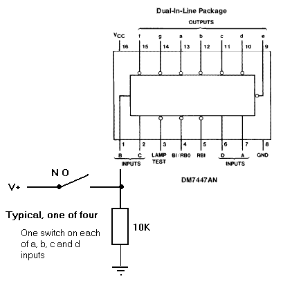

My 7-segment display only shows gibberish when I set any or all of the 4 inputs of my 7447 driver to low.
The 7-segment display has a common annode(I think?) (one +5 terminal)
I do NOT have a counter and am concerned this is the problem.
I want to use a manual 4-position rotary switch to display 1,2,3, or 4.
I get a '0' to display when I set LT to low (as expected).
Here is the diagram I used, though I do NOT have a counter, and pins 3, 4, & 5 are given a +5 supply. (though no difference when they are left blank)
Please help! Seems simple, but I don't know how else to research a solution.

When you set LT low, does the DP light up.?
The DP isn't connected to the 7447 so it won't light up on LT low. The other 7 segments should light though. If the DP does light, then something is wired wrong to the display.
With LT and the two blanking pins set high, and the 4 inputs low, you should see a "0". Set input Q0 (1) high, you should see a "1". Set Q1(2) high and Q0 low you should see a "2". What do you actually see?
You could have a bad segment in your display or a bad 7447, or more likely, something isn't wired right. If you mix up the outputs and connect them to the wrong segments, you'll get gibberish. Also, if you set the inputs to a pattern that doesn't correspond to 0-9 (e.g. hex A through F, or 1010-1111) you'll get gibberish patterns as I don't think the 7447 blanks on invalid inputs.

Note 'g' and DP at opposite corners of the LED, and he gets only '0' not '8' when LT enabled.
You'll need one switch on each of the 7447 inputs in order to give a binary number that can be read and displayed on the 7-segment.

Solved!
Unlike other projects I've done, this driver required low input on all four pins to get started. By removing the ground to Q0, I got the '1', removing Q1; 2, and expected binary combinations to follow.
I take it that this is what they call 'floating high'?
Can anyone recommend a driver and display combination that requires - or + input to activate? Rather than the removal of?
Thanks for everyone's input.
That is typical of TTL devices; they float high and have to be brought to ground to be low.
How is your rotary switch wired? You'll want to wire it so that it grounds out the pins you want to be low, and float the pins you want high. A diode matrix is the easiest way to do this, or you can do it with logic gates.
Why not use a 4511 (CMOS) decoder? It'll draw less power and you can use pull-down resistors to make the pins low, and apply Vdd to the pins to make them high.
