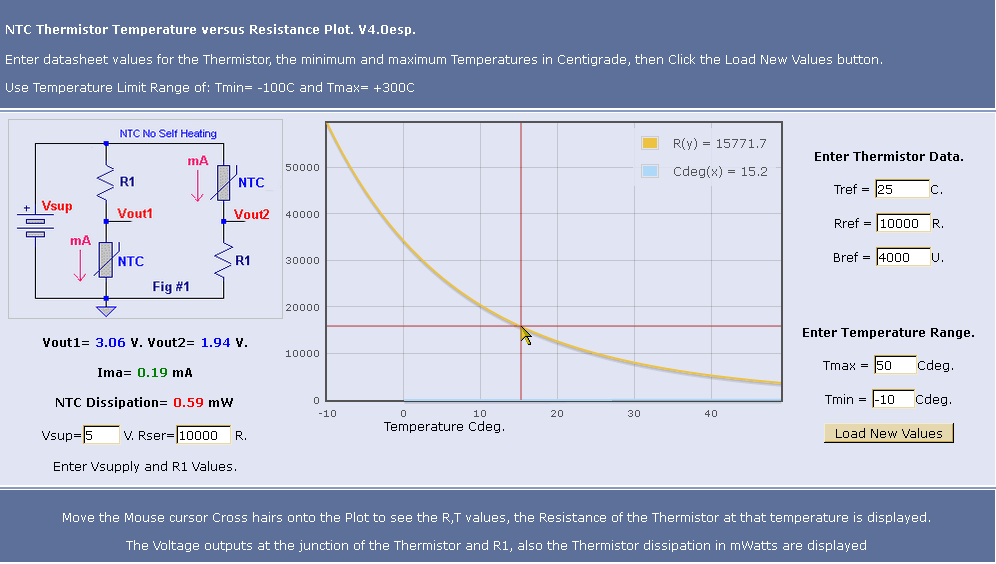

alec_t I am unsure how to do that in code. If I have a resistance scale can't I figure the result?
So, you have the R vs T scale.
Figure out just what T range your concerned about. The entire range will be a lot tougher.
The simplest is a voltage reference, a fixed resistor and the thermister to ground selected so your A/D has a good range and meets resolution requirements.min and max temperature. It may not meet one and you;ll have to change your method.
