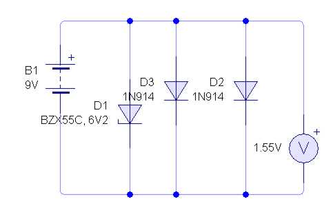

Okay, this looks good in simulation, although the zenner blows up (program fault...) The acual zenner may differ, this was the only model in the program.

Well, for a start, the diodes in the circuit are all the wrong way round!.
Secondly, piezo-tweeters aren't rated in watts, but in volts, I would suggest (as you've got plenty of them) using multiple ones in series.

yes, first off, you have all the diodes in parallel, instead of in series... the zener should be reverse-biased (cathode to + terminal of input) and the other diodes forward-biased. It wasn't a "simulation error", if you built that circuit you would in fact blow up all of the diodes.
Secondly, using diodes in that way to drop the voltage is not a good way to get a 1.5v output, since they are a fixed voltage drop... as soon as the nicads start discharging and their output voltage drops, your output is going to fall right with it, and even a little drop in each battery would be a significant drop as a fraction of the 1.5v output you want.
