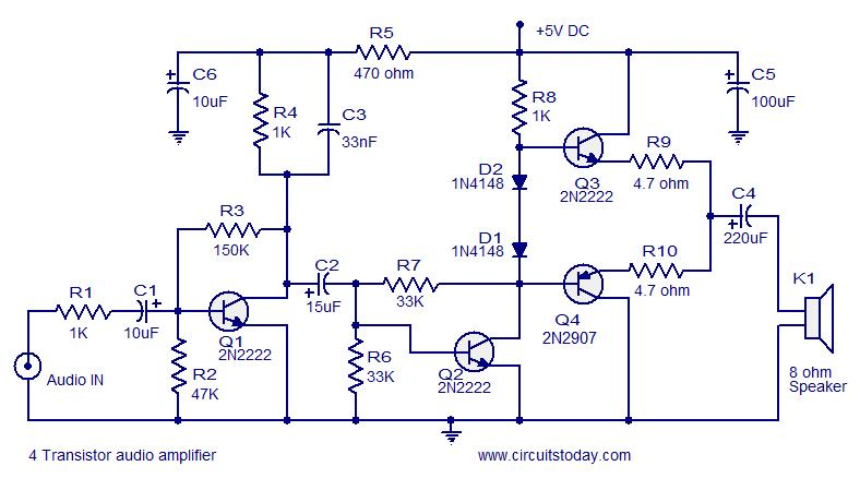

I have assembled a circuit published before:
With an input of 500Hz sin wave and 20 mv amplitude the output on 8 ohms speaker looks like this:
I am not good at electronics; should it be a single transistor I'd suggest the wrong operating point choice;
but what is this in case of compound transistor?
I noticed that distortions are getting smaller if I decrease emitter resistor up to 60 ohms.
Is this circuit diagram wrong?
It's an absolutely horrible 'circuit', and is never going to sound any good - there's no negative half cycles as you've got no negative drive capacity.
And yes, the circuit diagram is wrong.
The horrible circuit is designed by a student who knows nothing about electronics and writes with very poor English.
Build a proper audio amp with a push-pull output if you want to power a speaker.

I did have a feeling there is something wrong with this schematics, although I found if emitter resistor is decreased to 50 ohm then distortions disappear and amplifier produces a decent sound from 15 mV input.

I ended up yesterday assembling this simple circuit and it sounds quite good, no distortions:

There's still a LOT wrong with that circuit as well, but at least it's got a vague similarity to a working circuit - your first one didn't.
For a couple of quick things, no negative feedback from the output, so high distortion and not very stable, plus no bootstrapping of R8, so greatly reduced power output and even more distortion. It's a really, really, poor circuit - on a scale of 1 to 10?, perhaps a 1 or 2, where your first post would be struggling to get up to a zero. Using four transistors (and less passive components) you can make a 'proper' push pull amplifier, as used in commercial radios etc. for decades.

Forgive me my little knowledge of electronics...what is 'bootstrapping R8'? Were you trying to say in this highly professional way 'I'd connect a capacitor in parallel with R8'? Please use simple words, if possible, I'd appreciate that. Why do we need this capacitor? Something related to thermal stability?

you could linearize that a bit more by adding an emitter resistor to Q1, and running a feedback signal through a voltage divider and coupling cap from the connection of R9+R10. this will reduce distortion even more because global feedback will take into account all the nonlinearities between Q1 and the output. R8 as Nigel said doesn't allow the positive half of the waveform to reach near the positive rail. the "bootstrap" circuit he's talking about splits R8 into 2 resistors, and adds a capacitor to the output and the middle of the two resistors and boosts the + side voltage swing. another way to get the same result is the use of a constant current source in place of R8.

You did not see distortion because C3 was cutting all the high frequency distortion harmonics. C3 also cut high frequency audio making the amplifier muffled like an old AM radio.
I fixed it and got an output power 5 times more than before. The output power is still very low because the power supply voltage is very low.
Bootstrapping is when the output reaches down with C7 ands pulls up the bootstrap voltage on R8 and R14 allowing a higher output signal swing.

Thanks a lot! You know, resistors 0.22 Ohm are not kind of realistic. Does this mean emitters should be just connected?

The 0.22 resistors help balance the output transistors.
