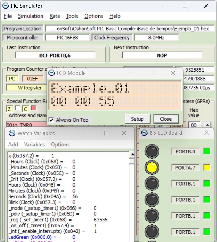

Hello again; this time I leave you a set of functions that use interrupts and a timer. They are used to distribute execution time between codes. This set of functions allows you to decide the number of times a certain code is executed per second. They call these types of functions "Time Bases".
I will leave some examples so that you can appreciate the importance of time bases in controlling the flow of our program.
Note: I have updated the example because it was only for simulation.
I have set the clock to work on a card.
I have updated the Timer Base functions to the latest version and the comments are translated.
Note II: "TmrBaseFunctions"; I uploaded the wrong file, so I upload the correct one. It only added 1mSec. more than the assigned delay (2023/03/07).
'Example_01
'Example of the use of time bases with timer1.
'By COS, 03/2023
'Pic Basic Compiler v8.42 (PSI), Pic16F88
'Clock internal 8Mhz
Define CONF_WORD = 0x2f50
Define CONF_WORD_2 = 0x3ffc
Define CLOCK_FREQUENCY = 8  '8Mhz Oscillator
'Define SIMULATION_WAITMS_VALUE = 1  'Activate for simulation
Include "_FuncionesPic16F88.bas"
Include "_FuncionesTmrBase.bas"
Include "_FuncionesDutyCycle.bas"
'Pin configuration
AllDigital
ConfigPin PORTA = Output
ConfigPin PORTB = Output
'LCD Port ----------------------------------------------------------
Define LCD_BITS = 4  'Data bus length to 4bits
Define LCD_DREG = PORTA  'Data bus: puerto A
Define LCD_DBIT = 0  'Least significant bit of the data bus.
Define LCD_RSREG = PORTB  'Rs control bit on port B
Define LCD_RSBIT = 7  'RS bit on RB7 pin.
Define LCD_EREG = PORTB  'E control bit on port B.
Define LCD_EBIT = 6  'E pin on RB6 pin
Define LCD_COMMANDUS = 2000  'Wait after each command in uSec.
Define LCD_DATAUS = 100  'Wait after sending a data to the LCD in uSec.
Define LCD_INITMS = 50  'Wait during display initialization in mSec.
main:
    'Clock settings
    Call _setup_oscillator_mode_select_bit(_oscillator_mode_defined_by_fosc)
    Call _setup_oscillator(_osc_8mhz)  'Internal clock at 8 MHz
    'Initialize Timer1
    Call _setup_timer1(_tmr1_internal, _tmr1_div1)
    Call _set_timer1(0xf831)  'Interruption every 1mSec.
    Call _timer1(_on)
    Call _enable_interrupts(_int_timer1)
    Call _enable_interrupts(_global)
    Lcdinit  'LCD without cursor
    Lcdout "Example_01"
    'Initializes time bases in mSec.
    Call _bt1call(_btsetup, 0)  '16Bit, initialize _BT1
    Call _bt2call(_btsetup, 0)  '16Bit, initialize _BT2
    Call _bt3call(_btsetup, 50)  '16bit, initialize _BT3 And reload with 50msec.
    'Assign names to the Leds
    Symbol LedGreen = RB0
    Symbol LedYellow = RA7
    'Initialize Clock
    Call Clock(23, 59, 00, 1)
    Call _pause(2000)
    'Infinite Loop
    While True
        'Blink Led green
        If _bt1if = 1 Then
            Toggle LedGreen  'Changes the state of the selected pin o bit.
            Call _bt1call(_btsetup, 100)  '100) 'Reloads time base en mSec.
        Endif
        'Blink Led yellow: _Bt2DutyMs(on,off) use time base 2.
        LedYellow = _bt2dutyms(100, 500)  '500) 'Led flashing (ON, OFF) in mSec.
        'Clock
        If _bt3if = 1 Then
            Call _bt3call(_btsetup, 1000)  '1000) 'Reloads Time base in mSec.
            Call Clock(0, 0, 0, 0)
        Endif
    Wend
End
