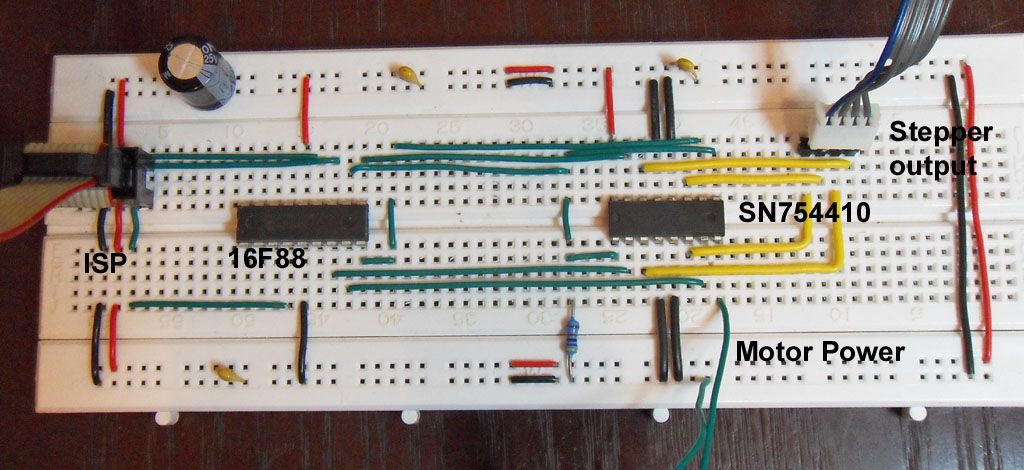

I had a circuit breadboarded that I used to teach a friend about stepper motors and so I thought I would have a play with it. This is the board,
And this is the code (in BoostC),

And this is what it does,
I set the delay at 4mS as at 1mS you couldn't see it.
The stepper is from an old Cannon printer but this size is available in lots of places. It's 200 steps per rev but I half stepped it so 90° is 100 steps. It draws 0.7A per phase and so the SN754410 easily handles it. This could all be done on a 1mS interrupt and so the main code could run a display etc.
To incorporate a second stepper to rotate the bobbin would be relatively easy and so a coil winder should be doable.
P.S. Just noticed I put ISP on the picture. It should be ICSP. Maybe InCircuit should be one word.:D
Hi Mike
Great work.
I will scan through and see if I can make sense of it all:eek:
So you have it automatically running it both directions can this be easily adapted to work from push buttons to set the limits?
I will give this my all as it's a very useful project BUT I have to be honest and say my coding skills are very limited.
If I were to purchase some components would you be willing to help out with the code when I get stuck as I'm very sure I will????:D
