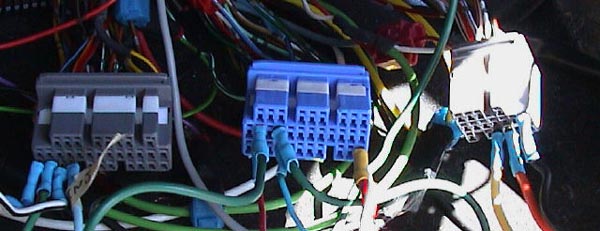

I think you'll find what you are looking for on the mailing list then. There are a lot of vehicles represented there. I've done basic testing on a car, just by unplugging the ECU and plugging individual wires into the wiring harness for testing. It's simple and means you aren't committed to anything if it doesn't work.
