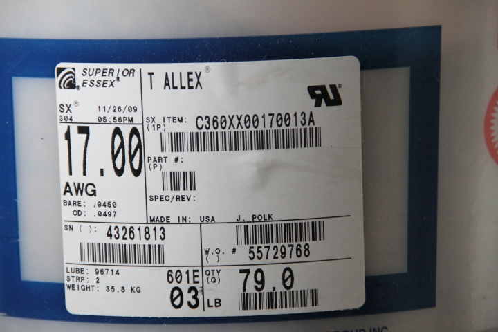

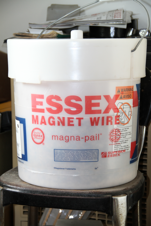

For some humor attached are a few images of Essex. One shows a label for AWG 17 (told you we use strange gauges) and the other the container it comes in. Note the bump on the top where the wire exits. Pretty cool huh? If you note the label you will see it was a 79 pound spool.
The wife feeds the birds and buys bird seed in bulk, like 25 or 30 pound bags. The wire pails we throw away make perfect bird seed containers. :) That plus other things like mixing paint or whatever.
