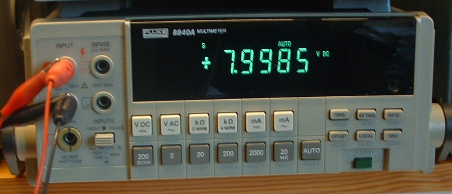

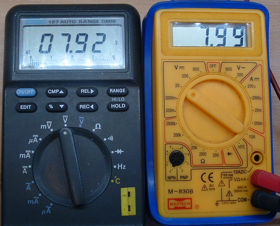

To put things into context with a practical demonstration, I connected three DMMs in parallel to a power supply.
I trust this several hundred £/$/Euro Fluke to give the most accurate reading:

On the left here is a £30/£40 20 year old Korean meter, on the right is a £3 10 year old cheapie from some big DIY store.
So it looks like the cheapy has quite good agreement with the mighty John Fluke.
You pays your money and you takes your choice.
