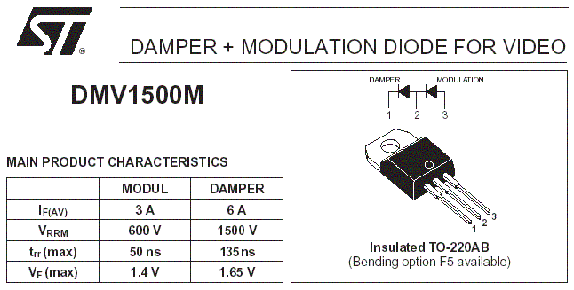

Anyone knows where to get the datasheet for this one?
Its a SGS-Thomson device, but I can't find the datasheet for it on ST's site.
It's a dual diode used in a computer monitor's E/W correction circuit. One of the diodes inside is shorted. While looking on the net I encounterd many other occurences of this problem so I want to replace it with a heavyer device so it will not blow again soon
I've not found Your type also on 1998 ST data, CD but maybe this type also can work in Your circuit...
