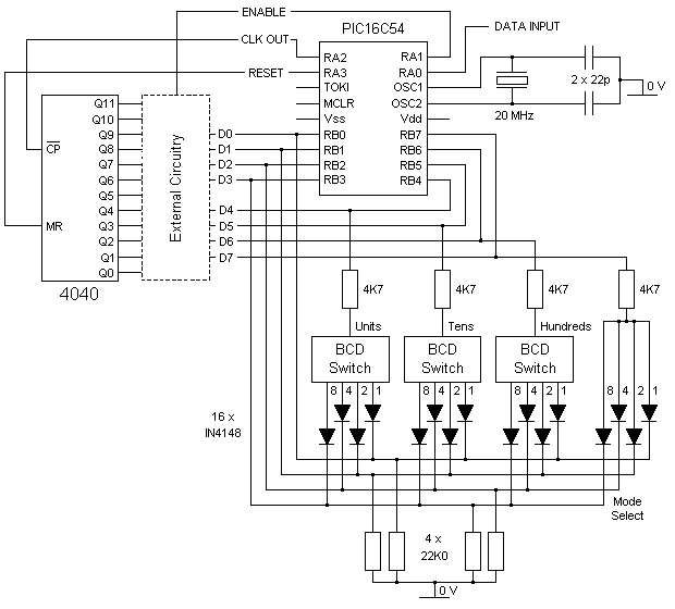

I found **broken link removed** using Google. The schematic is invisible (at least on my computer), but I managed to get it by opening it with Microsoft Photo Editor, creating the negative of the image, and saving it as a GIF file. There may be other figures that are also invisible.
