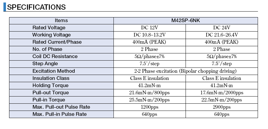

can anyone tell me what is the correct voltage and current need to drive Mitsumi M42SP-6T, 61 ohm stepper motor without heating....

From the data sheet...
Full datasheet....
Although there isn't alot more info than that already posted

hi, i am just looking the data sheet. i find just typ Mitsumi M42SP-6NK not mitsumi M42SP-6T.have the both typ same data sheet.
