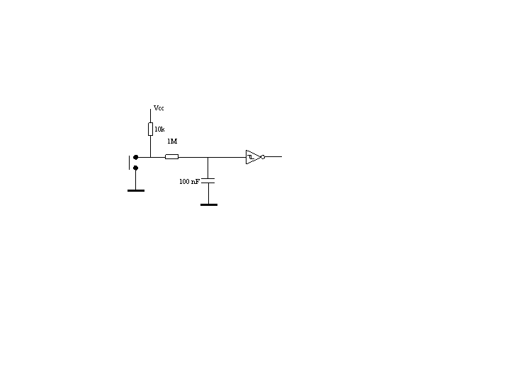

Here are 2 circuits that I use.
The time delay is approximately equal to the RC time constant.
It can't be predicted precisely because the CMOS Schmitt Trigger ICs have a fairly wide spread in their Vt+ and Vt- voltages.
The time constant with R = 1M and C = 100 nF is
1 * 0.1 = 0.1 sec. (if the resistance is in M and the capacitance is in uF then the result is seconds.
The IC can be a CMOS Hex Schmitt Trigger such as 74C14 or 40106, etc.
Or a 74HC version ie. 74HC14.

The OP used a huge 1uF capacitor and a battery-killing resistor of only 430 ohms. A 0.001uF capacitor and a 470k resistor would do the same thing. But a 470k resistor doesn't provide much current for burning dirt from cheap switch contacts so a 47k resistor with a 0.01uF capacitor should be used.
