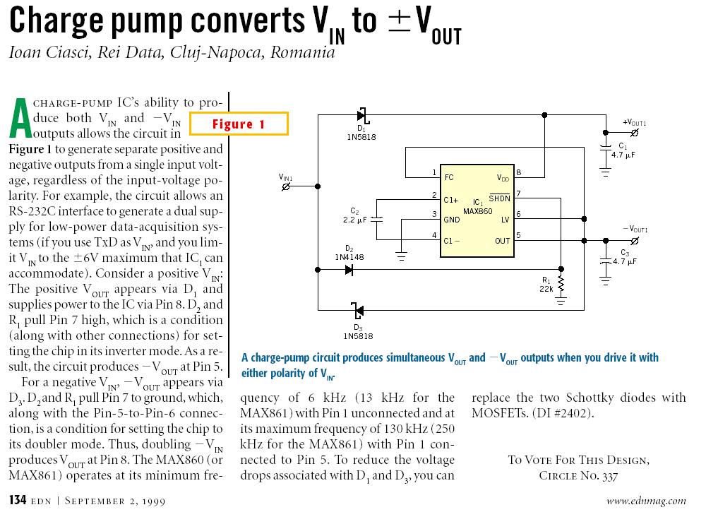

Doble supply from battery (+ / -)
how much current are you looking for from them?
I recall finding something like this a while back, not positive on the details, but it's a start for you. I'm sure some others will recommend something better, I doubt this can provide a lot of current too.

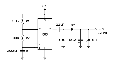

he wants a + voltage and a - voltage from one source.
You can do this if the load current imbalance between the + and - supplies is less than the output drive capability of the op amp.
Connect a couple of equal resistors in the hundreds of k range across the battery and drive an op amp connected as a follower from the centre tap.
Call the op amp output ground, and you now have + and - lines of half the battery voltage. Good for a few milliamps.
