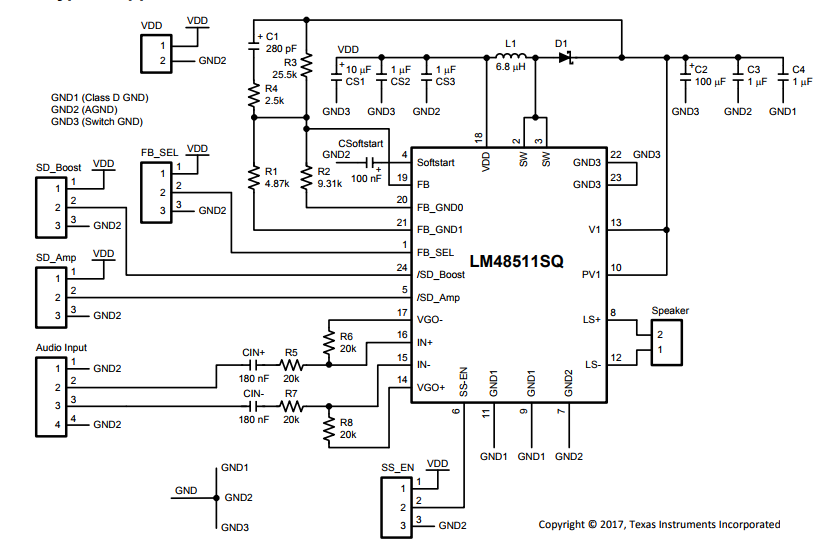

Hello there,
I am going to develop a circuit for audio power amplifier using, https://www.ti.com/lit/ds/symlink/lm48511.pdf
Looking at the application circuit , I am using SD_AMP(pin5) input for Mic input at pin 16 IN+. Did -IN pin grounded.
Trying to suppress noise at the circuit in attachment 2 in 300Hz-3kHz audio amplifier, using https://www.ti.com/lit/ds/snas371c/snas371c.pdf audio amplifier.
Kindly, let me know whats wrong I am doing here in attachment 2.

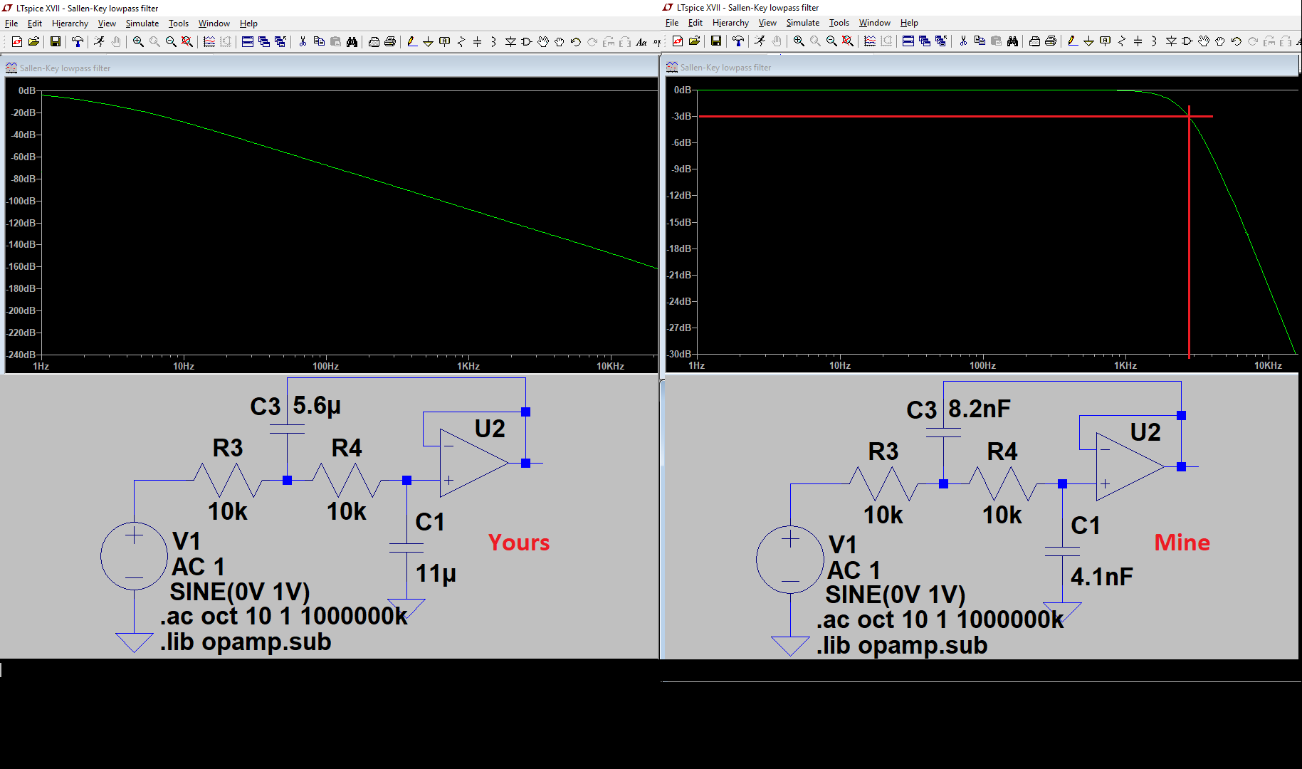

4) The Sallen-key lowpass filter cuts all audio frequencies. I changed it to cut frequencies above 2.9kHz, then speech will be difficult to understand and music will sound very muffled.
I wish to make it for Human voice, like waki-tokey!

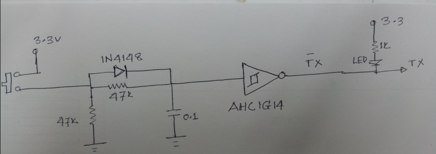

How about to make a Tx signal by non inverting Schmitt trigger 74AHC1G14; take a look,

Please learn the formula of a coupling capacitor. 0.01uF into 10k ohms cuts frequencies below 1600Hz.
0.01uF into the 4.7k ohms at the output cuts frequencies below 3400Hz. Also the 4.7k ohms at the output feeding a 32 ohms earplug attenuates the signal to 1/148th.
This information proves that MIC inputs are not more then 1600Hz? My allowable range is 300Hz to 3kHz, need to change the values?
Yes, you must calculate, not guess the capacitor values.

Human speech produces consonants letters p, t, k, h, f, s, m and n that produce frequencies up to 14kHz. Also speech produces digraph sounds sh, ch, th and zh that also reach 14kHz. "Th" and other sounds are done different ways. The word "this" and the word "thin" have the "th" digraph sounded differently. When the high frequency consonant sounds are not produced then speech is difficult to understand.
I do not know why you need a tx signal.
Dont you mean this formula ?
Need to study more, but dont you mean 14kHz component should be included ?

Actually, in this design I have connected both L and R signal together in 3.5mm phone plug as their behavior is almost same if you consider superposition, just use 10k with one of them.
This application will allows to speaker in some time to speak through, other wise it will go to main circuit. What do you suggest for de-bouncing in this circuit, diode 1n4148 is OK?, how about to use a RC filter after push button?
Yes. Normal clear speech includes all the consonants and digraph sounds that I listed that go to 14kHz. If you cutoff frequencies above 3kHz like an old fashioned telephone then speech is difficult to understand and the conversation will be full of "what?" or "say it again" or "spell it". Without the high frequency sounds then the words "sailing" and "failing" sound the same. If you cut high frequency noise then you also cut high frequency speech sounds.
Then you hear the same in both earphones. The resistor is not needed.

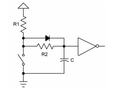

Your debounce circuit is fine without the diode. Aren't you going to use the LM48511 power amplifier with SD?

Your explanation indicates my design would be poor, I am confused also in this sense that, LME49721 output current at RL = 250Ω, VS = 5.0V, about 9.3-9.7mA. May be you are ignoring LM48511.
What I have did is, I have tied those L and R signal together, connect them with 16th +IN pin of LM48511 with RC filer.
Other IN- pin is grounded.
Now all those voltage and current sensing will handle by LM48511, results will be show on +LS and -LS.
I am still keep in mind.
Dont you consider the recovery time of diode after getting an bouncing from switch?
What are you making? You have two mics in a noisy room and stereo headphones connected for mono.
You hear your own voice until you press the TX button then you do not hear your voice when transmitting?
The debounce circuit can be made with one resistor, one capacitor and the Schmitt trigger. The capacitor immediately charges fully on the first contact and discharges only a small amount if there are contact bounces, then discharges completely when the button is released.
Nice description, dont you suggest the matched RC values.
The switch quickly charges the capacitor the moment it makes contact then the capacitor stays charged during contacts bouncing. Then when the switch is turned off the resistor parallel with the capacitor slowly discharges the capacitor. One resistor and one capacitor, plus the Schmitt trigger so nothing is matched.
Yes, correct. Capacitor discharge need a resistor path. I think we can change the push switch button in this way, need a resistor afetr 3.3v to switch,
The diode is an optional part needed only when the math goes haywire. It's possible, with the wrong sort of gate where the hysteresis voltages assume other values, for the formulas to pop out a value for R1 + R2 which is less than that of R2. In this case the diode forms a short cut that removes R2 from the charging circuit. All of the charge flows through R1. The equation still applies charging_equation.PNG , except we have to account for drop across the diode. Change Vfinal to 2.6 volts (3.3 minus the 0.7 diode drop), turn the crank and R1 pops out.
