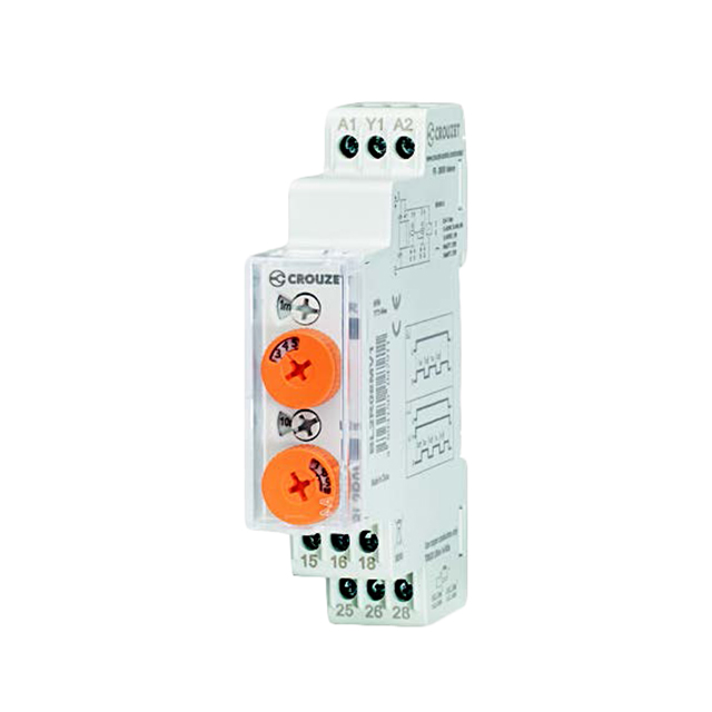

I have some of these. You need to get the right version. They have 220VAC or 110VAC or 24VDC etc.
There are adjustments. (seconds/minutes/hours) and 1-60 (adjustment for off time and for on time)
You will have to insert wires into the ports. "Y1" , "Y2".
It is not a nice finished product. It is a part that is used to make something.
These things are used to run elevators and automatic doors. etc.
okay, it looks a bit extreme for my use, but is it just the same principle as on that short cycle timer in the picture above yours?
Can you for example adjust it to 7 seconds on, 20 minutes off, 7 seconds on, 20 minutes off etc ? Adjust it exactly how you wish with the cycles in seconds and the off- intervals/pauses in minutes ?
