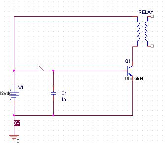

A fast drawing, I might need a transistor more, but just to get a quick overview of my idea how the capacitor should work.
The actual idea is to make a timer (not an accurate timer).
Nothing should happen before the switch is pushed just a half second, and then charge the capacitor that will lead current to the transistor for some time.
I want to do this because right now I just use big capacitors to held a short time. This might make me able to get more time with a smaller capacitor. But can it work? In my head, the capacitor should be able to charge without sending the charge current through the transistor, tus not damaging the transistor.
I wont use this timer IC :) I want to make this work. Ill go to bed, but am back tomorrow morning.

It is a "burn out" circuit.
The circuit as shown will charge the 1nf capacitor as fast as possible then the unlimited current will burn out the base-emitter junction of the transistor.
Then when the transistor turns off the high voltage flyback spike will destroy the transistor even more.

Whatever as I have no clue what you are trying to do? However Audioguru sums the circuit description (as it was drawn) up nicely:

Ok but what if I put 24k resistor in between transitor and capacitor.
12v/0,0005ma= 24000 ohm
Then it should maximum get 0,0005ma to transistor, or am I wrong?
