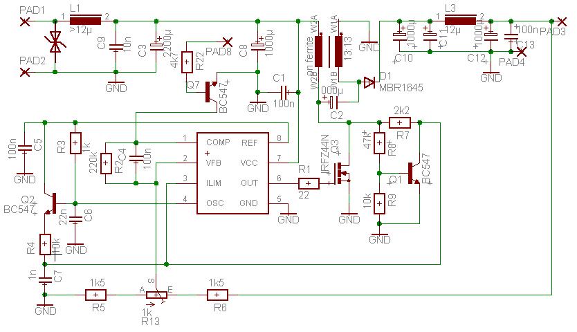

I made one powersupply that does exactly what you described. I found this page **broken link removed**. I took some model from there (or to be more exact, almost copied the whole thing) and made my own. I also made a 12v and 3.3v output model, easily adjusted with by R5 and R6 and finetrimmed by R13. I made this for my car computer. The efficiency of my version on PCB was about 75%, but I think that it will increase when i finetune the coil leads. This design should be capable of delivering many amps (8 according to the website).
I added a small heatsink to the diode and MOSFET.

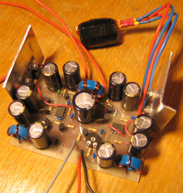

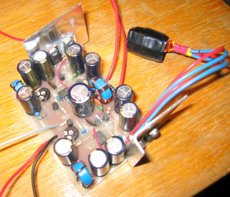

Here are the EAGLE files, if you find them of any use, and some pictures of my 12v and 5v board. I put two supplies on one board. The gray wire is for shutdown, in case you wonder what it's for.
As you can notice, I haven't yet soldered the coil for the other supply. I might also say that the coils DO sing if you have a big load :D so one must make them firm with epoxy, harz or someting similar :)
Edit: I should point out that there are 6 jumpers in my PCB design, just so that potential builders know about it. The jumper to the right supply should be thick, because its the powerlead for the whole right supply.
