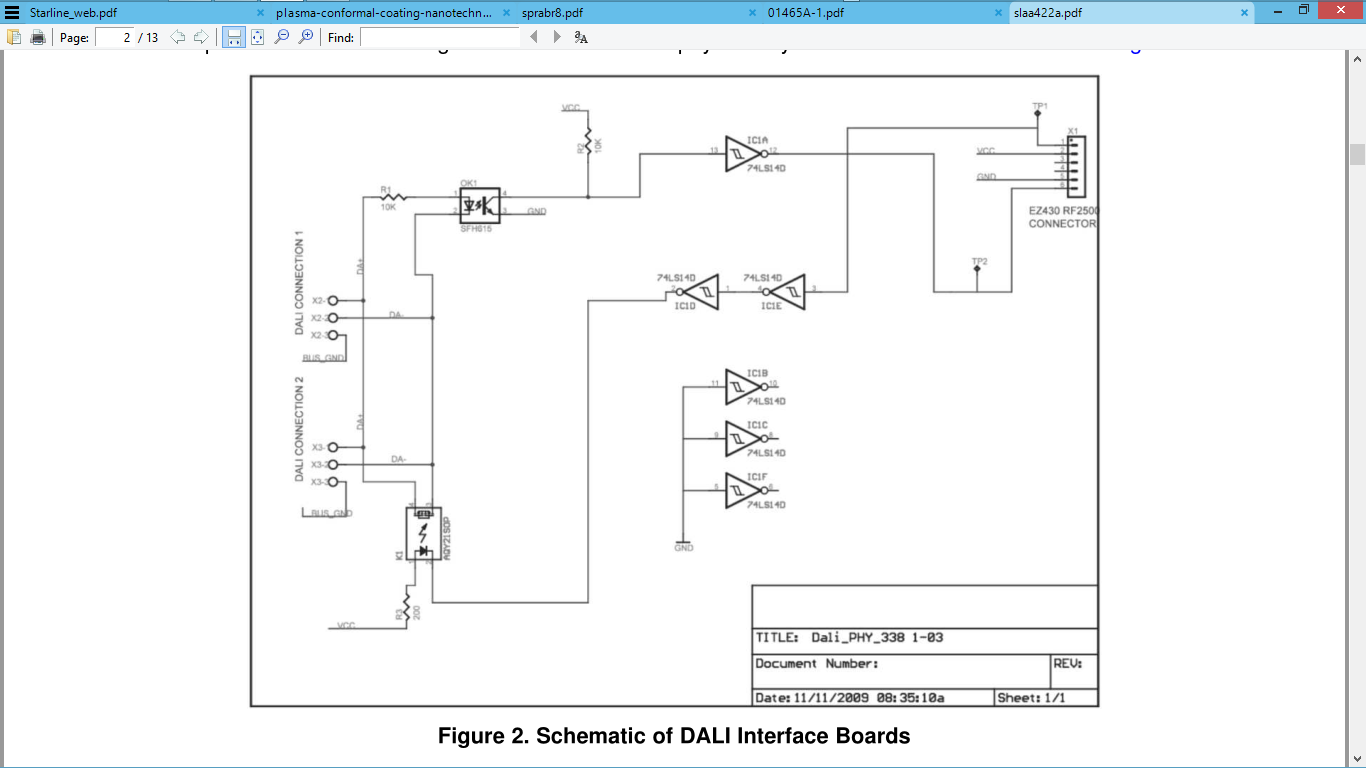

It shows the biphase Tx and Rx protocol with opto isolation .

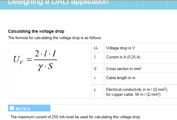

Designing a DALI application
DALI Manual | 08-2013 | en 59 / 93
Current draw of the DALI circuit
Each device in the DALI circuit consumes current via the DALI circuit. The total current draw on the DALI circuit must
not exceed the maximum current of the DALI power supply.
To determine the current draw of a DALI circuit both the current draw of the DALI devices and the current draw of the
DALI controllers must be taken into consideration. The current draw of a DALI device is defined in the DALI standard
as 2 mA. The current draw of the individual DALI controllers (ComfortDIM devices) is shown in the relevant data
sheets.
It is important that the current draw of the DALI circuit does not exceed the maximum current of the power supply. In
the case of DALI-PS and DALI-PS1 this is 200 mA.
Example: DALI circuit with 24 dimmable ballasts (PCA EXCEL), 3 DALI-GC and 3 DALI-SC
Current draw of the individual DALI components (from the data sheet):
Total current = Σ Current draw of DALI devices + Σ Current draw of DALI controllers
Total current = 24 x ballasts + 3 x DALI GC + 3 x DALI SC
= 24 x 2 mA + 3 x 6 mA + 3 x 6 mA = 84 mA
Maximum cable length
The maximum cable length depends on the maximum permitted voltage drop along the DALI cable; this is defined as 2
V max. Typically, this requirement is safely met for a cable length of 300 m and a cable cross-section of 1.5 mm².
Additional voltage drops at terminal points must be taken into consideration. For cross-sections smaller than 1.5 mm²
the maximum cable length is reduced accordingly

I guess you didn't catch my drift with my searcheresult link... TI chip shows TTL 74LS140 driver and receiver so you can compute current from that chip spec and others in circuit...I hope...

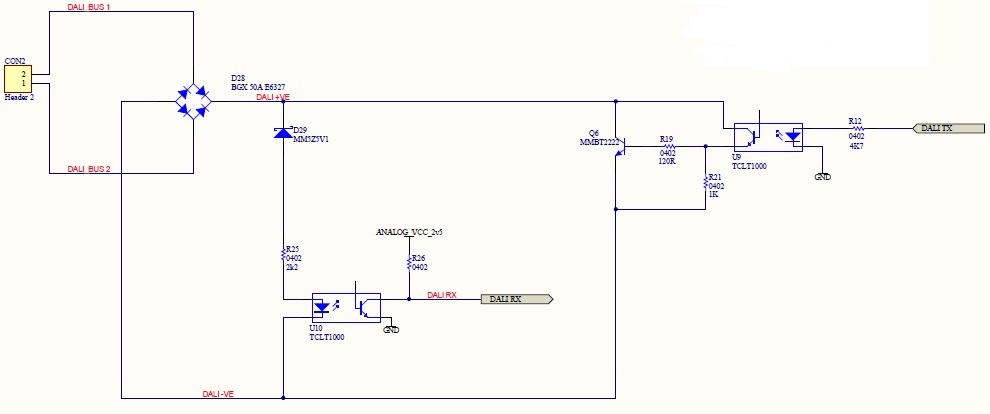

Thanks, this is our DALI TX/RX circuit, but our TX circuit , as you can see, could never draw 250mA from the DALI bus. I will look into you kindly supplied docs.
The DALI-TX drive voltage is just 2.5V.
The bus is intended for hundreds of nodes, so 1 will never do that.
