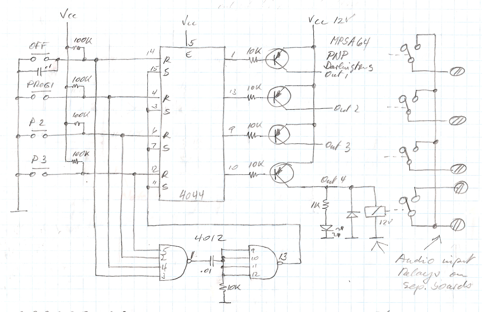

I posted this circuit on this forum before.
The 0.1uF across the "off" switch is required to turn on the off (ouch!) on power-up. All switches are momentary. The system is interlocking. E
