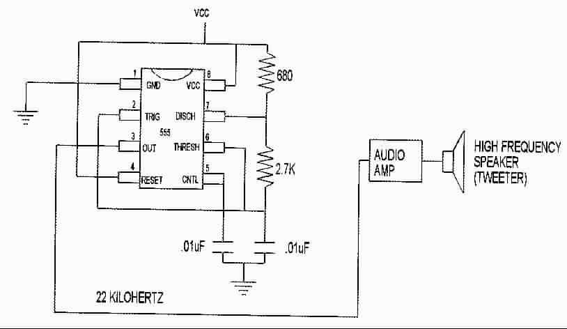

I wish to adquire or have built a powerful ultrasonic dog repeller.
Something that will either scare them off or hurt their inner ears and keep them away as far as possible.

You can make this as powerful as you want. VCC can be between 5 and 15 volts.
Thank you for your answer.I will take your design to an expert to help me with.
In the realm of fantasy I would like to be able to point a design to a distance of about 20 or more meters and keep the animals away,or to bother them enough so they do not return.
Is it a matter of decibels,frecuencies,speakers or another factor?
Good day Horatio:
Regarding your range specification. It seems to me that the two most important factors to keep the dogs away would be the frequency of the sound, and the decibel level of the sound.
I have read that dogs normally respond to ultrasonic frequencies between 12-25 KHz, depending on the age of the dog. As you can reason, older dogs may be less sensitive to sounds based upon what ear damage has already occurred.
As far as the decibel level, some of the ultrasonic systems that I have seen, operate around 80-90 decibels, which isn't entirely too loud.
Consider this: Normal human conversation is between 30-60 decibels. A quiet recording studio would be around 10 decibels. Also, power tools and aircraft are usually around 110-130 decibels. (Source: www.coolmath.com/decibels1.htm).
So with that frame of reference, 80-100 decibels might be a pretty good range, especially since dogs ears are more sensitive than human ears. The human ear threshold for pain is around 130 decibels, so I'm assuming that dogs may have a lower threshold for pain as well. An adjustable output decibel level would be preferred.

I once build na astable mutivibrator(whith the potencimeter you cod adust the freq.) adn i conected it to a smal specer.I opend the window conected the power and thurned the potencimeter until i codnt her it.then dogs in half of a neiborhud gone nuts.trugh on a lower freq. (1000 Hz) you cod hardly her it 3 m avey. imagene what wod hapend if i wod drive it in to my radio tower (120 W specers)
