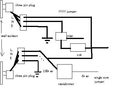

If i use veraboard??(brown plate with ready made holes for pins ,not a protoboard) instead of PCB, the jumper wire to connect the power out and in to the other component such as triac and VDR, can i use the usual single core jumper or use a specific jumper that can withstand 240V?
thanks.
fiz
The generic jumper useable up to 1..2A just for experiment.
If this circuit not dimmable,i recommend for triac driving an optotriac. For veroboard experiment You can use simply a LED for indicating.

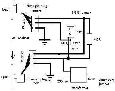

actually what i mean is the wire connected to the power line. I'll attach a picture. the bold lines the the one that connect to the power line. if pcb is used, the wire for those lines should be thicker or not? So for jumper(used usually with experiment using protoboard ) that i mean is the thin line. what's your recommendation?
is my sketch the correct interpretation of the circuit??
thanks
fiz
The PCB track thickness depend from load current. How many amperes (or VA) the load?

oh i thought the power out goes to another wall socket. thanks for the input. this may sound stupid to you but i'm not sure what device the load is suppose to be. Is it the x10 receiver or the appliances we want to control? Isn't x10 suppose to enable us to control by remote as long as connected to the same power line?
can you show me how the connection is supposed to be? I'm a bit confused.

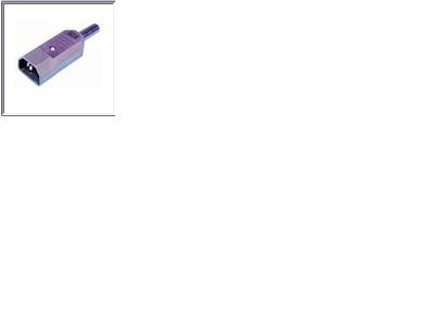

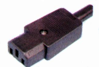

Is this the three pin plug (female&male)
This sematic show one of many receivers with switchable output by triac. You can plug it into any wall socket, and connect a load to output. All receiver have independent address, and with transmitter You can send a command to receivers. So You need a receiver for each load (wall socket)

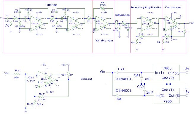

the previous circuits is for the transmitter.

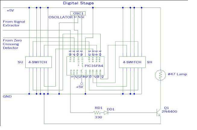

this is the receiver circuit i got from the internet. Can i use D1N4148 for DD1 and also what kind of lamp can i use for #47Lamp?

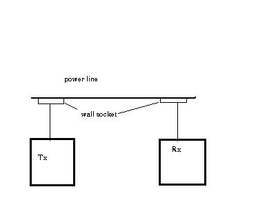

i email someone who knows about x10 and he said that the transmitter circuits is actually a tranceiver so it can send and receive the x10 signal. and the power out connection is for whatever load(appliance&lamp) that we want to control.
So if i want to control a light bulb maybe around 60W, can i just connect it directly to the power out?? how i can i do that? can you show me the proper connection?

Yes, the 4148 work fine in this position. If Your load only 60W bulb, no need a heatsink for triac, and just connect it to power output.
For experiment quite enough an isolation-transformer about 60...100VA as the application note show. (The circuit suck very low pover just the bulb 60W)
