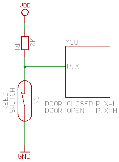

I m doing this project in which the unit (microcontroller,pcb) is placed inside a cabinet.
I need a sensor for detecting any attempt of theft, as in, if anybody opens the door of the cabinet a command is send to the microcontroller.
Another sensor is required for detecting the water level, if it goes low below a certain level, the uc gets interrupted.
What kind of sensors i shud go for and where can i find theory about them?
If anybody could provide help on these two things.....
For the door, look at magnet/reed switches like those used in home alarm systems. For the water level detector a float switch would be the simplest.
Look at how switches are interfaced to micro-controllers.

I searched about the reed switches and yes they are appropriate for my application. But how do i connect one to the door and its interfacing to the microcontroller...?
like this.
If you require the signal inverted connect an NPN transistor between switch and MCU port pin.

like this.
Or, reverse the positions of the resistor and reed switch.
Also note, when purchasing reed switches that some are normally-open (N.O.) and a magnet closes the contacts. Others are normally-closed (N.C.) and a magnet opens the contacts.
Ken
Ken
That depends on the kind of MCU. Some only understand an active pullup, and want to see ground potential (or close to ground) when low.

I am going to use atmel's 89s52.......i searched on reed and float switch, but their are many varieties of them available, which model should i go for....?my app is a simple one, so not complex one's i guess.....?
For the float switch, you have to be specific about the water container you're monitoring. Each type of float switch works best in a specific environment. Though the "app is a simple one" the "devil is in the details". Can you give us details.
For the door switch, something like this: Directed 8600 Magnetic Micro Switch - RadioShack.com
