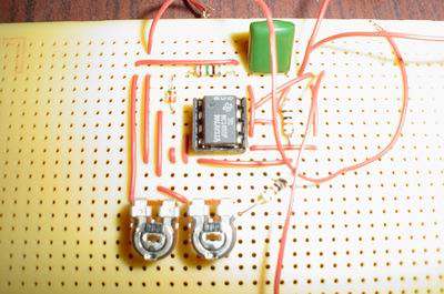

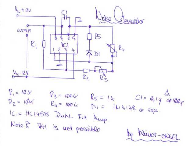

here is the circuit i use with 741 op but show 3.05V as inout was 0.5V :roll:
so all of u r saying 741 will not work :(
then what should i do plesae coem up with any circuit will be great
What people are asking for is the circuit (schematic) diagram, not your board layout!.
But without drawing it out, I would be surprised if it only puts out 0.2V, I would expect a simple sawtooth oscillator like that to output a great deal more - probably approaching the supply rails!.
A 741 is an extremely old opamp, and far better ones are available, a 741 is always going to restrict the design.

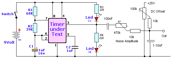

are you sa\ying you want a 23V Dc signal BUT you want some noise on it, so you trying to get a 0.2V pk-pk triangle wave and then give some DC offset so you end up with
Vtri + 23V
thus giving you the "apperance" of 0.2V worth of noise on your DC signal?
If this is the case the 0.2C pk-pk with a DC offset isn't really noise
samcheetah said:
or is it the other way round? :?
because 0.2V of noise (ripple) might be there in the first place if the project is powered from the wall socket.
i think he wants 23V of noise
23V pk-pk of noise? true it could be that.
But the whole point of these question is
We need some more infomation!.
What do you want this "noise" for. 23V is quite high a voltage (for a signal) - what is it feeding? why do you need a noisy signal for?

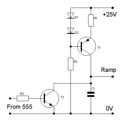

Anyway, here's one simple solution to the problem:
Use a constant current source from a 24V (or so) power supply to charge a capacitor, the top end of the capacitor is the tuning voltage for the varicap.
Place an NPN transistor across the capacitor, collector to the top, and emitter to ground.
Feed the base of the transistor from a squarewave oscillator, a 555 would be suitable.
When the base of the transistor goes high it turns ON, discharging the capacitor, when it goes high the transistors turns OFF - allowing the capacitor to charge in a linear, giving a nice sawtooth ramp.
The constant current, capacitor value, frequency and mark space ratio of the oscillator, will all require calculating (or finding by experiment).
imgemini said:
if will be great ful if u give me value,s of circuits R? C? and all other,s
'YOU' need to work them out, based on your particular design choices, the operation of the circuit is pretty obvious - we're not here to do your assignments for you, although we don't mind offering suggestions :lol:
