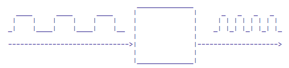

I ran into the following question:
Use Logic Gates in order to double the output frequency, as follows:
question-png.45942

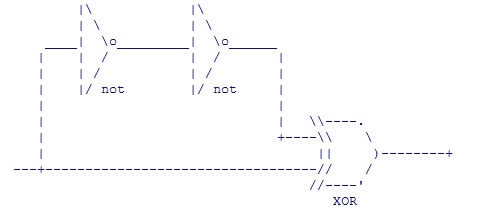

The suggested solution was that:
answer-png.45943
What do you think of that solution?
In this case, Tout(HIGH) doesn't necessarily equal Tout(LOW), right?
Tout(HIGH) - duration of output being HIGH, at a single period.
Tout(LOW) - duration of output being LOW, at a single period.

It will work.
But as you note, the output is not typically symmetrical. The high period will be approximately equal to the gate delay of the two "not" gates in series, so it could vary from a few ns to several tens of ns depending upon the type and speed of logic gate used.
You can increase this time by using addition pairs of inverters, or using a Schmitt trigger non-inverting gate with an RC delay in place of the inverters.
