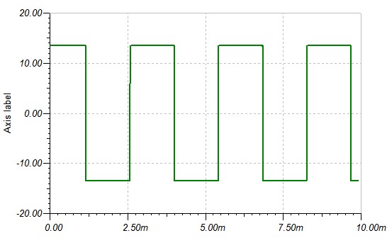

Sorry but you took it in the wrong sense. I don't want you to solve the problem entirely for me. I just need some guidance. As per the data sheet of Tl802 op amp, two values of slew rate is given, i.e 8(min) and 13(typ). Now which one to use. Anyway it's clear that i need to make the R and C value as low as possible to get the maximum frequency. But i am confused about the maximum limit possible for it. Now, if you could help.
I would use the "typ" value, then run the simulation and see if it is close. If you're using a TI802 sim model, it probably is usning the typ(typical) value.
I tried with the typ value i.e 13 in Pspice software. But the theoretical frequency which i get as the maximum doesn't match with the simulation result. I mean both the values aren't close at all.

Who said I didn't believe you? You said your sim didn' match your calculated value. I asked to see your work so I can tell if you made an error.
I'll need to see your work if I am to spot an error. You've shown almost nothing so far.
Just explain me this : What is the logic behind finding the maximum and minimum frequency of oscillation of an op amp type astable multivibrator ? What is the general approach ?
