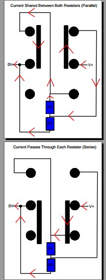

Hi Adam,
You don't need to use Multisim for this problem; a simple pen and paper will be more than sufficient.
Have a look at the attached drawing; you'll see there's a series connection of two resistors, and also a parallel connection of the same two resistors. Note in both configurations one of the terminals of R1 remains attached to the positive supply, while one of the terminals of R2 is always attached to the negative supply... so your DPDT switch could just be used to change the connections of the remaining terminals of the resistors (or light bulbs).
Good luck!

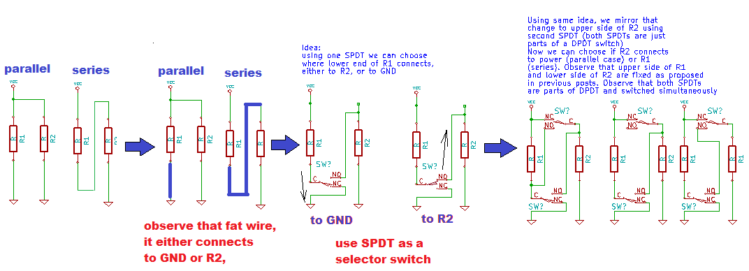

if you look at circuit posted by dougy83, and consider using SPDT to switch one of the resistors, you should easily see how to to that part. for complete solution, you ue the other half of the switch (second SPDT)

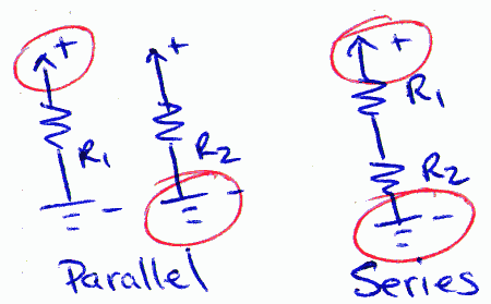

Is this what you are looking for?
Sorry for the sloppy schematic. I couldn't find the specific symbol I wanted. The switch terminals are the green circles. The redish line represents which terminals are connected in each position. When the contact is up, the resistors are in series. When down, they are in parallel to the 12V source and ground.
I think the lesson here to learn is that when wiring a DPDT switch, always think of crossing.
John
there are several solutions, here is example of some of them and how i got to them

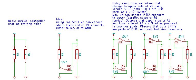

i'm sorry that you still have trouble with it. it is really not that complicated, just draw out EVERY step of what you know and what you need.
here is a bit longer version, i hope it helps. the key point is how SPDT switch works. there are three terminals:
C - common
NO - normally open
NC - normally closed
either NO or NC are connected to C (except during transition while moving switch).
DPDT is the same, it is just pair of SPDT ganged together.
