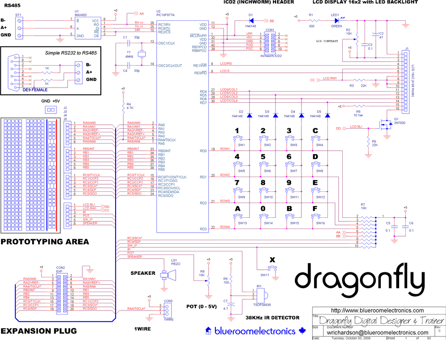

Dragonfly 16F877A PIC Tutor with LCD & 4x4 keypad. Comments?
Here's the beta schematic for kit #2.
It's a companion PCB for the Inchworm ICD2.
It's got a 16x2 backlit LCD, 4x4 keypad, piezo speaker, IR input, POT, Switch, 4MHz & 350 Solderless Breadboard & 20pin expansion header.
It's targeted at simplicity and low cost yet useful. You should be able to build 100s of projects with it.
The 16F877A was chosen because it has the most free complier support.
4MHz was chosen as an introductory speed, nice 1us clock and is the default speed for a great deal of PIC software.
It's also somewhat small approx 4"x6" to fit into a Hammond sloped case.

Do you mean this board? It's $119, and compared to the not yet completed Dragonfly its... The problem I have with the Basic Board and the EasyPIC4 is their "debugger" is really a simulator (done on the host computer). An true ICD uses hardware internal to the PIC and will support MPLAB.
Dragonfly Basic Board EasyPIC4
ICD2 add $45CDn bootloader programmer
MPLAB ATOM Basic proprietary
$79CDn appr $119US $119US
2x16 LCD with Backlight 2x16 LCD add $15
6 LEDs 8 LEDs 35 LEDs
12 buttons 4 buttons 36 buttons
350 breadboard prewired dip switches, jumpers
2 pots 1 pot 2 pots
Case optional no case no case
etc.............................................................................
If you want a basic compiler (a good one IMHO) with a demo version use a 16F877A and PICBASIC Pro Demo (free for 31lines of code and works with MPALB) Not sure how good ATOM Basic, what other PICs does it support? Here's a comparison table
The Basic Board would be better if sold minus the ATOM compiler, It's an 16F877A with a MAX232 (rs232) 8 LEDs, 4 Pushbuttons, speaker, LM7805, jumpers and a LCD. Should sell with the display for $50 or so. There's the DHMicro board for $109US available too.
Aside from the LCD display I'd be willing to bet I could teach as much if not more on my $69US Firefly T & Inchworm combo. If you must have an LCD you could always wire up an external 3 wire LCD circuit.

IMHO PIC demo boards with serial ports and 2x16 LCD displays are very common, even the Firefly has a serial port. The Basic Board is more a tutorial system like my Firefly is. Dragonfly is a Prototyping system. I would say the DHMicro is more along the lines of what I have in mind for Dragonfly.

Your impending board sounds like a good fit for the hobbyist or student. Do offer it up front with an LCD installed, even if the price goes up a little. Getting err and status messages in real time at the board does wonders for troubleshooting. Are you touting any high level languages for this?

Good luck, William, with Dragonfly. Please keep us up to date on this design.
