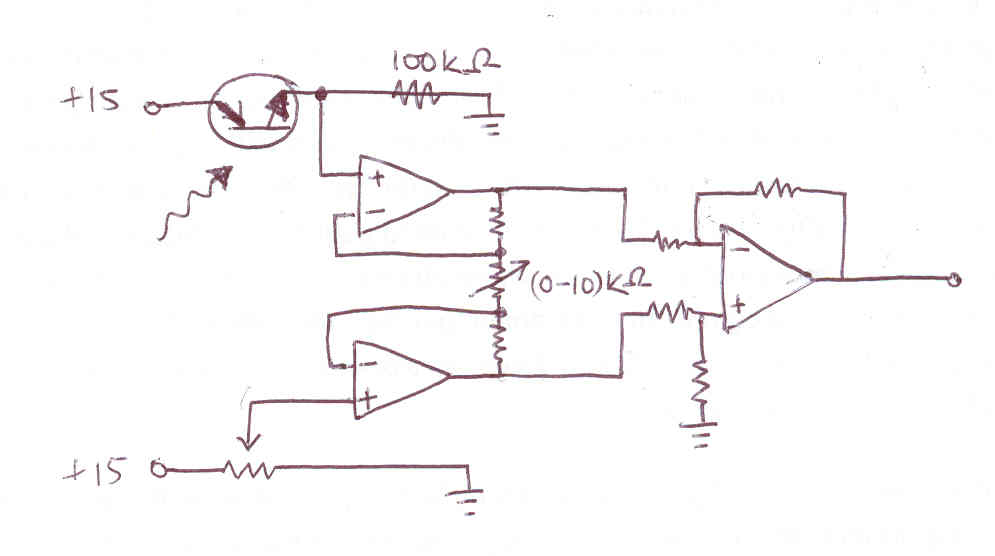

Fish, how about supplying a schematic of just the phototransistor and amplifier, with adjustments, as you now have them.
Here's a schematic, as requested. Haven't really got around to changing anything. All resistors are 10 kOhm unless otherwise specified. Op-amps are LF356.[/img]
Another solution I tried yesterday was to use a voltage buffer and an inverting amp. Not much improvement.

Fish, you're in luck. You don't even have an input which requires a fully differential stage! So no 3 amp stage, no instrumentation amp. You only need to read resistor voltage drop, and that's already biased to ground. So a simple 2 resistor single op amp amplifier stage works great.
You're not trying to read the voltage across the phototransistor. That's a current-based output, so you need to read the voltage across the resistor. Note that you can increase the voltage of the signal by increasing the size of the resistor, as long as the absolute DC value of the resistor voltage does not get too close to the supply voltage (perhaps this is the case?)
You need a low offset op amp though. Some have an offset of 4mV or more, which is most of your signal if you still have the resistor giving you only a 10mV output. The chopper amps are great- LTC1051, LTC1053 have extraordinary low offset error.
First off, thank you everyone for their input. Simplicity won out; I modified the mechanical aspect of my experiment to increase the signal by 10-20 times, and used a simple 2 resistor amplifier (using an OP07) as Oznog suggested, with a potentiometer offset adjustment. I think that's working well.
But I'm still having problems. Ron, I believe, already forsaw that the phototransistor drift would be a problem, and it is. The overall circuit is now stable for about 15-30 minutes, which is a huge improvement, but still unsatisfactory, due to the phototransistor drift. Any suggestions on what to do about the phototransistor drift?
One problem is that transistor leakage roughly doubles every 10°C. It should be relatively independent of the voltage across it. If you can find two phototransistors whose dark currents are closely matched (the current will be nanoamps), try this:
Couple them together thermally. One will be your sensor, which you leave connected as you have shown. Make sure the other one receives NO light. Connect it in parallel with the load resistor (100k in your schematic), emitter to GND. This should provide compensation for leakage current. It will not compensate for Hfe (beta), which also increases with temperature, but it should help.
Another possible problem is your nulling pot. Try to minimize the adjustment range to just the range you need by using series low tempco resistors. For example, if you only need ±1 volt of adjustment, use a 10k pot with 30k to GND on one end and 35k to +15V on the other end (use nearest 1% values).
