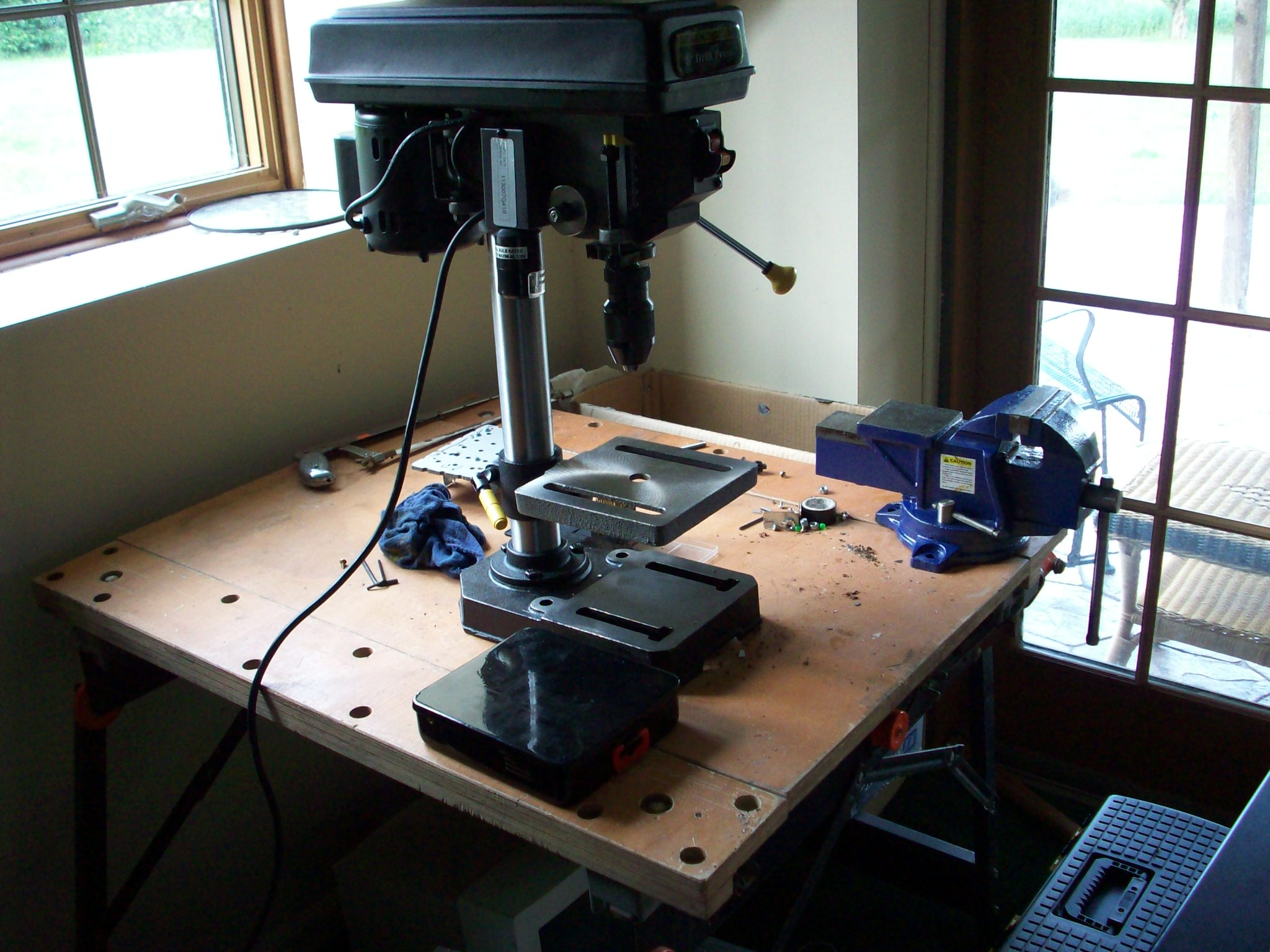

first pic: Drill press, vise and drill bit box :)

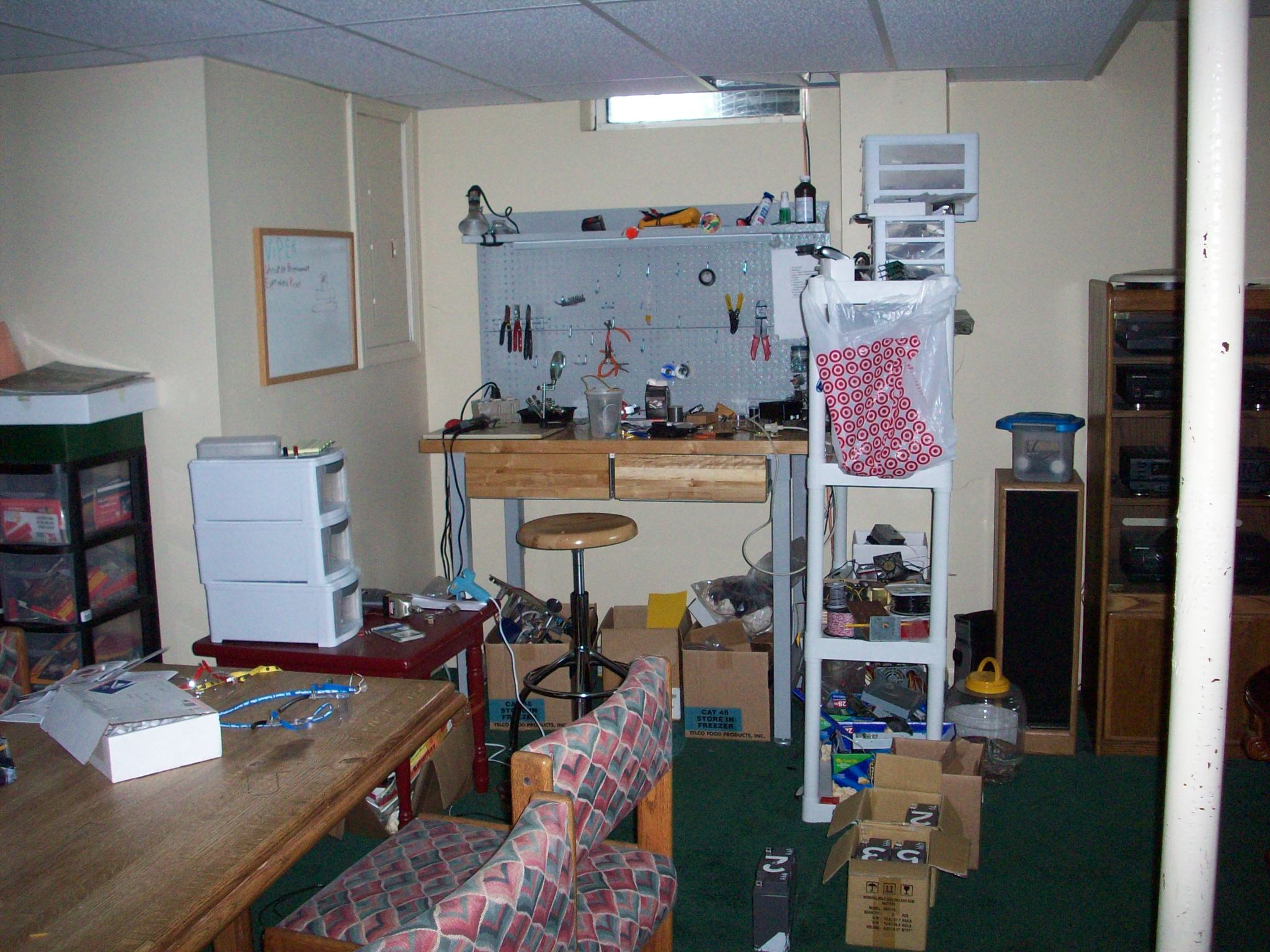

2nd pic: Electronic work station, the black containers on the left are film pictures (pfft) and the oaken table that has taken a beating (from me). Note the Ferric Chloride spill and black sharpie outline of something.

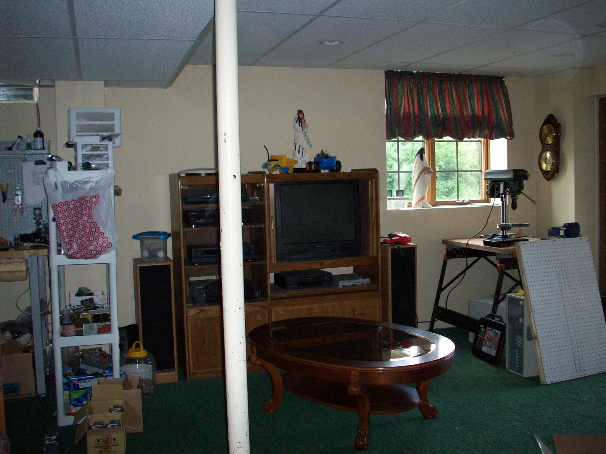

3rd pic: Entire setup. TV in the middle, even though I have not turned it on for a few months.
EDIT: This is my basement, not my living room, etc (hmm drill presses and soldering irons in the living room how stylish)

Just one observation, in the image, the drill dosnt appear to bolted to the bench, if not, I would bolt it firmly down.
Place it so the daylight on the drill table isnt obscured by the body of the drill.
Also get youself a pair of eye goggles.

I know, I am a slob. Quite a mess eh. How do you make the images the clickable type?

Your pic has made me feel a lot better, I too use my benches as shelves, looks just like yours...:rolleyes:
I use the 'manage attachments' button to add clickable pics.

As mentioned earlier, fix the drill press to the bench.
