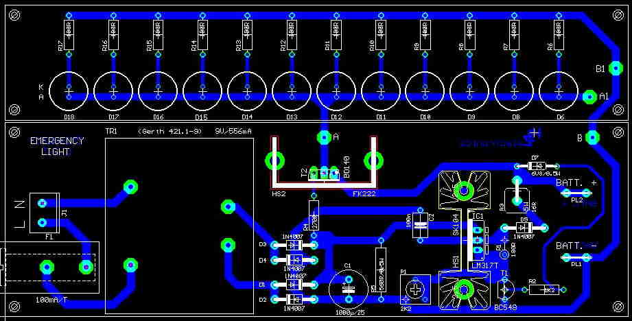

Hi to all interested in building the circuit,
I have designed a PCB including the changes as suggested: 560Ω/0.5W resistor across C1 and base resistor of T2 reduced from 1KΩ to 270Ω. Additionally I put four 47nF capacitors across each connection of the bridge rectifier. (makes the LM317 happy) The transformer used is a Gerth print transformer type 421.1-9 with max 556mA.
The entire design is purely single sided.
The design can be used as one single board or might be split into two as outlined in the dimension drawing. Connections between boards are marked A-A1 and B-B1.
Everybody interested in the layout (and schematic) is welcome to obtain it free via email. It is made using Eagle v. 4.16.
Here's a screenshot of the board.
Regards
Hans

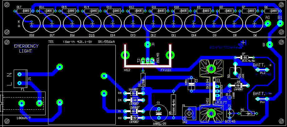

Emergency light
... and here a space saving version.
