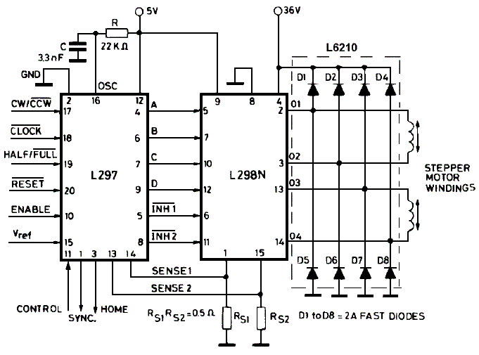

I need help in the schematic circuit between ULN2003 with L297 stepper motor controller...
Any Pros here can help me in the circuit designing ??
:oops: Thanks Alot for the Help
ULN is an open collector-type driver, not a good choice for stepmot.
Need a dual H-bridge for bidirectional control.

UCN5804~M42sp-5
Thanks for the suggestion...
Now I am trying out UCN5804 to stepper motor(m42sp-5) directly....
Anybody can give me the schemetic that connect both... just to double check with my own drawn up diagram....
