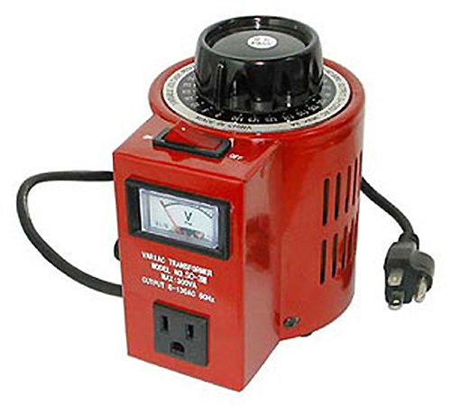

I have some of these. Input is 220VAC and the put put can be adjusted from 0 to 260VAC.
1) Variac transformer with knob to set speed.
2) Diodes to get DC
3) Capacitors to filter.
2) Diodes to get DC
Yeah, we use these all the time at work for the exact same thing too. The only weakness is you cant automate it onto a closed-feedback loop, but if you don't need that then it's far and away the cheapest and best option. You need big-ass caps though since there is ripple. We use 4mF caps with ours and it's still more ripple than I would like (especially at lower voltages since the ripple is constant and becomes proportionally larger as you turn the voltage down). Well, your flywheel should fix that anyways.
Shortbus, yep I've just been reading ludens's site, having trouble with a control loop I'm working on, need to fudge in a pole.
Futterama, yep the teensy is a good board I've used one in a frequency standard project, adafruit do a couple of differently named boards with a similar chip, one has wifi.
My largest RF transmitter (20kw) used a variable transformer, with a motor that turned the knob. (I was just controlling the voltage on a grid not the full power) Above 103% power, a relay closed and turned the voltage down. Below 95% power another relay closed and turned the voltage up. Between 95 and 103% no power went to the little motor.
