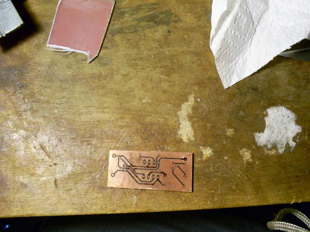

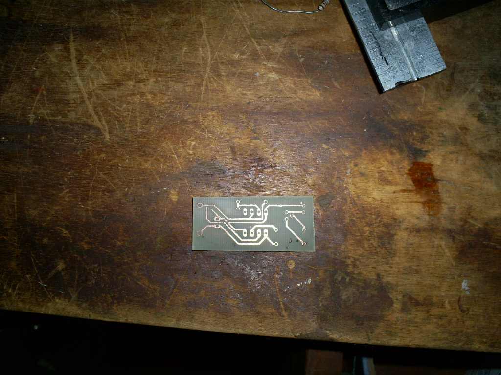

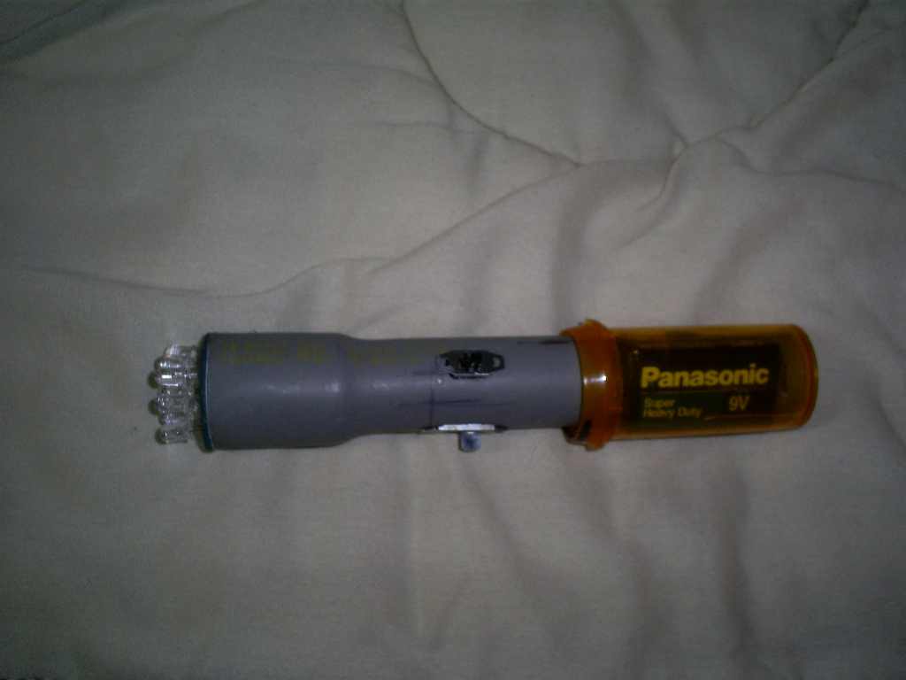

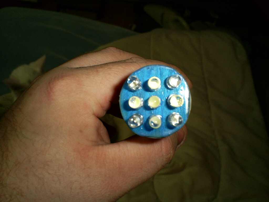

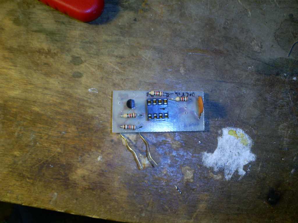

Heres the Finished Product. I made a flashlight using the circuit, what a PIA to get the circuit board to fit...
Technical Data:
Powered by a 9V battery
9 LEDs, 4 Blue (because I dont have anymore whites) and 5 White LEDs (They are all in parallel with each other)
"Doom 3 Flashlight" (low) Setting: 20.6mA
"I see you" Medium Setting: 47mA
"All Hail the sun" High Setting: 66mA
On the "low" setting you can still see, but its for Power Saving. Most of the time I really cant get to this mode, its because of the ultra small switch Im using. On "medium" power, it can get you around in a house, and On high, it practically lights up the room.
Note, I can Increase the number of LEDs without Increasing the current needed to operate the flashlight. Ie, I took measurements with 1 LED and then put 9 LEDs on the circuit and found that current only increased 1mA in most cases.
So now your wondering, "How long will this thing last?" (all numbers here are estimated based on graphs from batteries- Go take a look on Energizer.com under technical info)
https://www.electro-tech-online.com/custompdfs/2006/12/522.pdf
Low Power- Est Resistance: 450Ohms
Med Power- Est resistance: 191.48 Ohms
High Power- Est Resistance: 136.36 Ohms.
Low Power Longevity (hours): Appr 40 Hours If the battery was at 6V
Med. Power Longevity (hours): Appr 20 Hours.If the battery was at 6V
HighPower Longevity (hours): Appr 12 Hours If the battery was at 6V
It may last Longer or shorter if the battery was a 9V. Only one way to tell, Get a fresh 9V and let it run all night!
Your flashlight doesn't need 9 LEDs since at the High Power setting they are each operating at only 66mA/9= 7.3mA. Their max rating is 30mA each. So two LEDs in series and in series with a current-limiting resistor could be doubled to 4 LEDs with two resistors and would be brighter and use half the current so the battery would last for more than twice as long.
They arent in series with each other, it seems there wasnt enough voltage to drive them in series. Each LED Requires 3.3V, BUT each is only getting around 2.67V. So each LED is getting Pulses of 66mA (They are in parallel of each other..)
