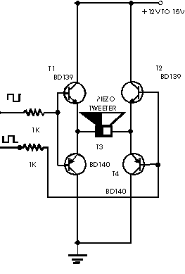

Howdy:
I am attempting to build an ultrasonic "Dog Chaser" using a classic push-pull driver (circuit attached), and a cheap Piezo Tweeter. I use a PIC to output varying frequencies of 15 - 17 - 21 - 23 - 25 - 27 - 30 and 33 KHz, in two and 1/2 second bursts, then repeating. The output from the driver is definitely functioning, changing frequencies as it should. (I can see the proper frequency output on a Scope) The thing is - I can hear something at all of the different frequencies, which seems to tell me that the tweeter is not oscillating at the driven frequency.. with these old ears I would doubt that I would hear even 15KHz.
The speaker is connected as shown, using 9 volts (not 12 as shown) across the driver. The PIC outputs (which are out of phase to each other) are connected to the 1K resistors feeding the transistor bases. The PIC shares a common ground with the driver.
The Tweeter has the specs shown below:
*Similar to KSN1016 *Power handling: 50 watts RMS/75 watts max *Frequency response: 3,500-27,000 Hz *SPL: 94 dB *Dimensions: A: 5-3/4", B: 2-3/4", C: 2".
I realize the top frequency response shows 27 Khz, but the lower ones should be OK.
Should I be applying a higher voltage to the tweeter so as to drive it harder? Or is there something simply stupid with my approach?
Ken
That will work.
You don't need any base resistors though as they're emitter followers.
Obviously you'll need more buffering and level shifting to drive this from a microcontroller.
ozark you're probably just hearing harmonics. I can almost guarantee you're going to need more than 9 volts to get full power out of that piezo though, check the voltage rating on the data sheet, or find out what it's impedence at resonance is. Even tiny low power piezo's can handle / and or need 20+ volts to produce full volume. Try to keep the bursts short too, 50 watts at 20+khz can damage hearing, even if you can't hear it.
hero 9 volts is going to give you 50 watts out of a piezo tweeter??
The piezo tweeter makes a horrible high frequency speaker. Its frequency response is full of peaks (resonances) and notches and it has such high distortion that the harmonics beat and create lower frequencies (intermodulation distortion).
A 50W into 8 ohms amplifier has an RMS voltage of 20V. The transistor circuit will provide it when its supply is about 11V and the signal is a square-wave.
The piezo tweeter has an average output of 94dB at 1W/1m so at 8m to 10m distance it will not be loud.
Dogs will ignore the sounds.

The piezo tweeter uses hardly any power because its current is very low. Therefore an amplifier is not needed, the four little power transistors will be fine.

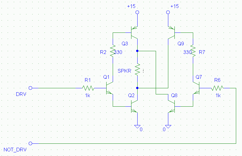

The circuit you posted is an emitter-follower, and even though you have a supply of 12-15v, the voltage across the piezo won't exceed the 5v you are powering your microcontroller from. As someone said earlier, you'll need to translate from the microcontroller output voltage to the driver supply voltage.
An example circuit attached is shown that will give almost the full supply voltage swing to the piezo transducer.
Good point!
I forgot that the 4.5V inputs (with the loading of the transistors) form the micro-controller causes only about 7.4V p-p across the speaker which is only 2.6V RMS and the power into an 8 ohm speaker is only about 0.9W.
