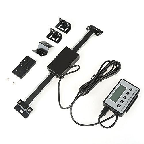

I am using units like this one to get digitized values for the machines in my workshop:
What I have yet not found is the kind of interface to the display and control unit is being used here. I want to use an ESP32 board to gather the digital data from the sensor and use a HMI of my own design on a normal display so that X-, Y-, Y- and Angular-Data can be displayed. The EPS32 additionally allows it to connect to display and/or PC via Wifi and/or Bluetooth.

The scales in the picture look like ones made by a company called iGauging. They are not quadrature scales.
Here is some information on the original iGauging scales but I have heard that newer ones use a different protocol.

You will need to look at the data and clock signals between the scales and the display unit to identify the protocol being used.
Here is a link to an interface I built for reading the original iGauging scales and some protocols used on some other Chinese scales that also includes links to other information on DROs.
http://lesjhobbies.weebly.com/interface-for-yuriys-android-dro.html
