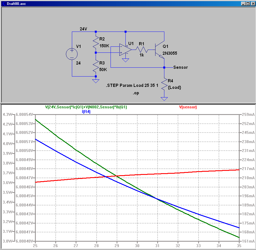

Attached is a circuit that would work. The simulation shows the voltage regulation (red trace) as the load resistance changes from 25Ω to 35Ω. The complex expression shown in dark green is the power dissipation in the 2n3055 power transistor. The blue trace is the current through the simulated load resistance (your sensor).

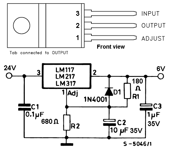

You could use an LM317K (TO-3 case) or an LM317T (TO-220 case) attached to a heat sink with a low thermal resistance (<15C/W). It's simple with the advantage of having current and thermal protection.
The easiest would be to use a LM317. The LM317 will disspate 3.6W at a 200ma load so be sure to heatsink it. You need a mica washer, insulated screw washer, and heatsink compound between the LM317 and the heatsink because the tab will have 6V on it.:
Yes I agree, use the LM317, it's certainly the easiest solution.
