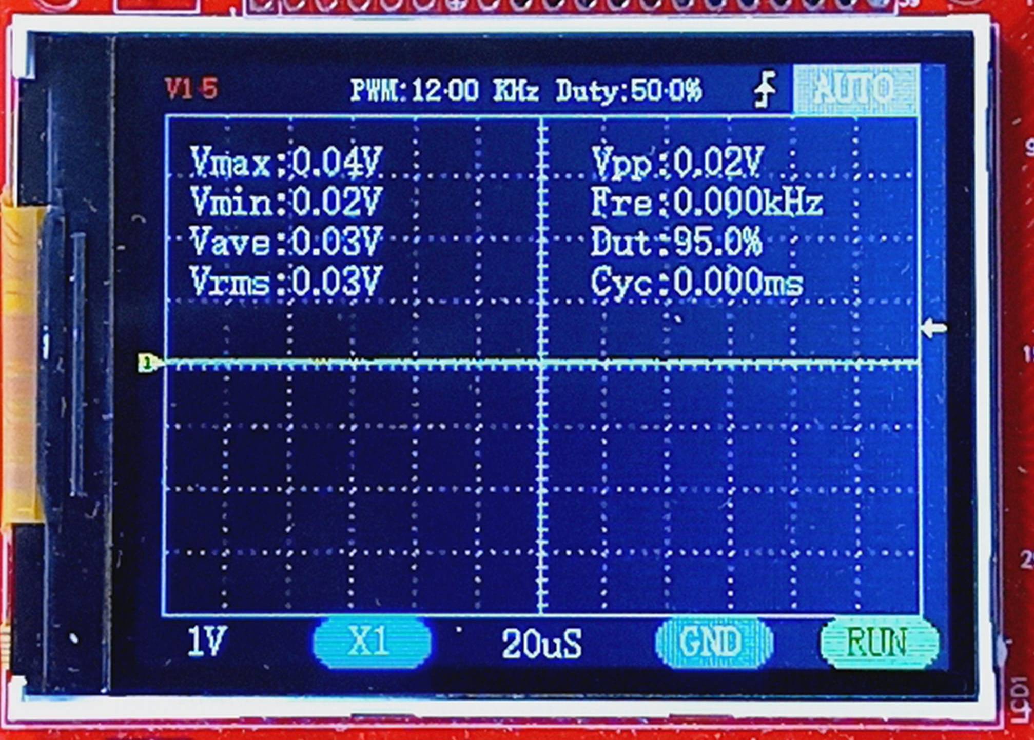

2) there was an offset (even in GND switched mode) of about 0.86V that I could not figure out how to clear. Online I did not easily find anything related to this issue on this model.

2) click SEL several times until the left cursor that indicates your zero is selected, then old down OK! Voilà!

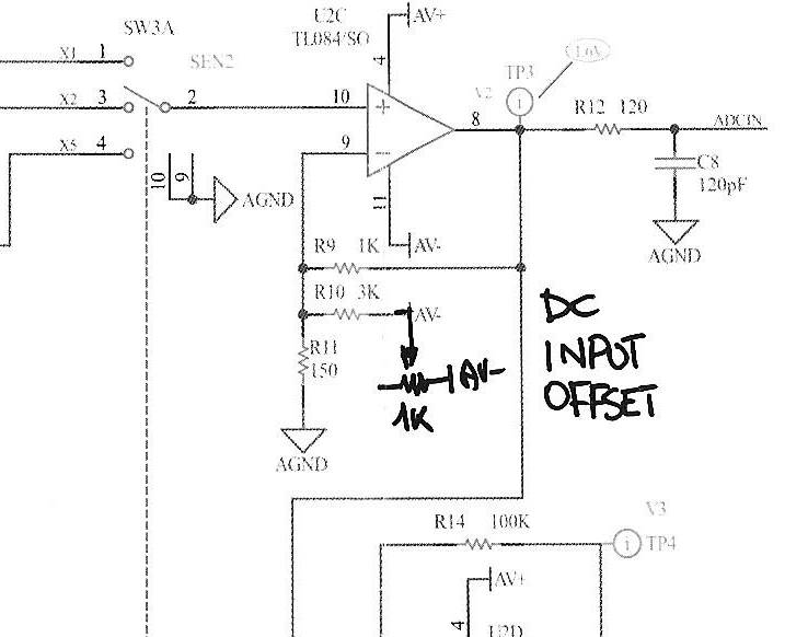

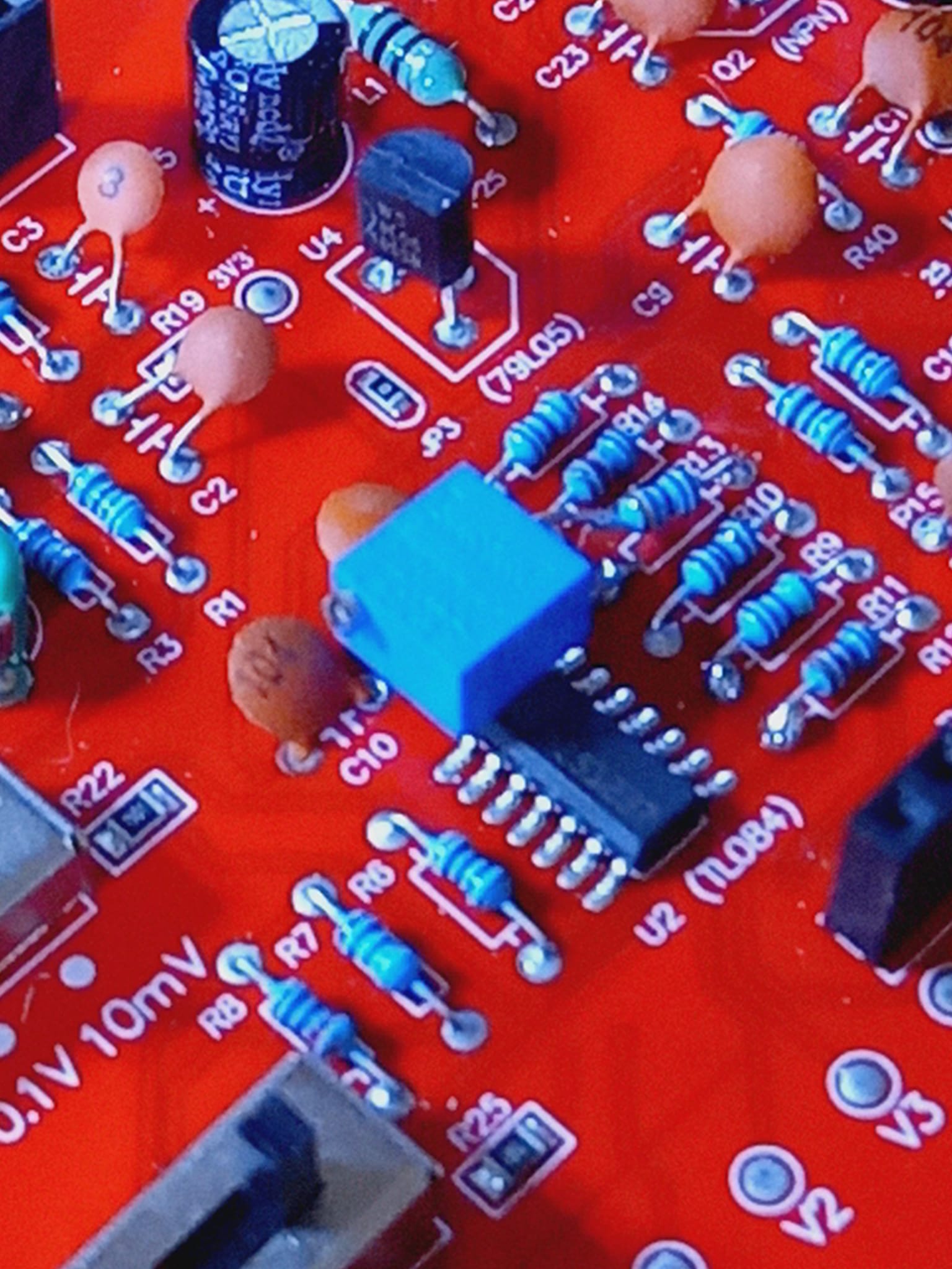

I managed to correct the offset problem-
AV- is correctly regulated by the 7095 at -5.09V and R10 being exactly 3.00KOhm, so the offset must be caused on U2C V+ input. In any case, adding a 1K multiturn trimmer in series to R10 allows for quite a span of Offset correction. A lower valued for the trimmer would be enough, but that's what I had handy.

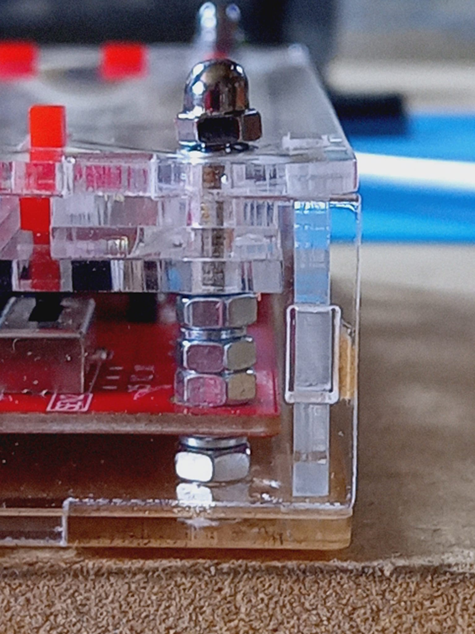

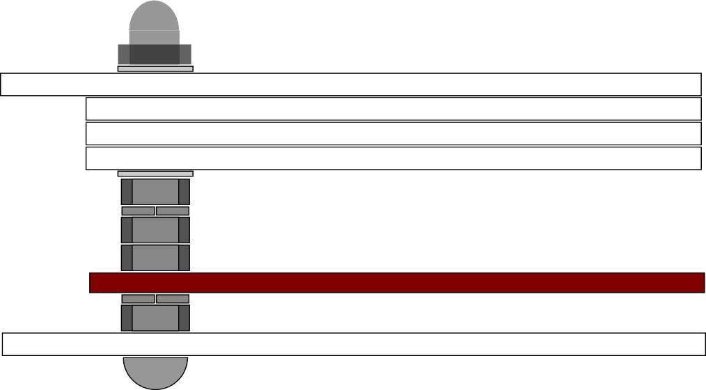

The assembly of the unit in the plastic case can be easier and more steady with spacer bolts and washers like this.
Adding a couple of washers underneath the board, It keeps everything tight together with the buttons and sliders sticking out just enough.
To me, without spacers the whole assembly is unstable and the controls are too lose.
